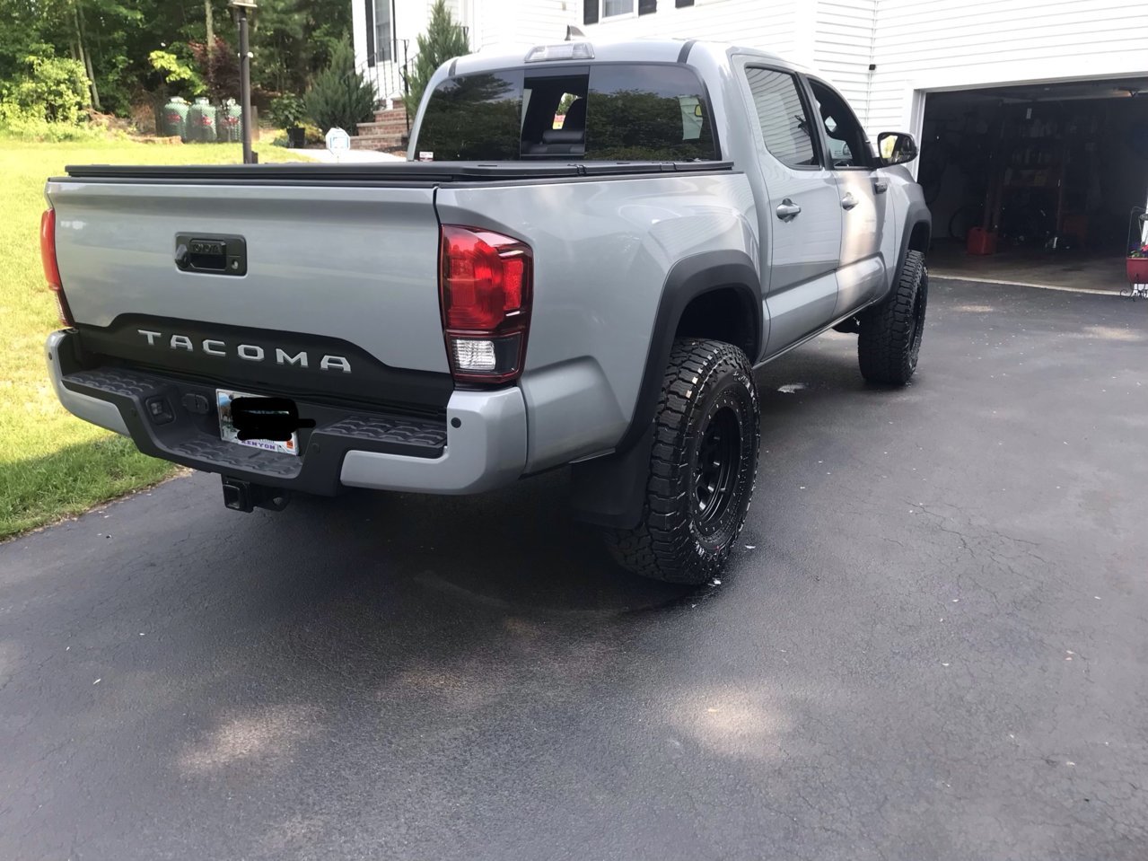

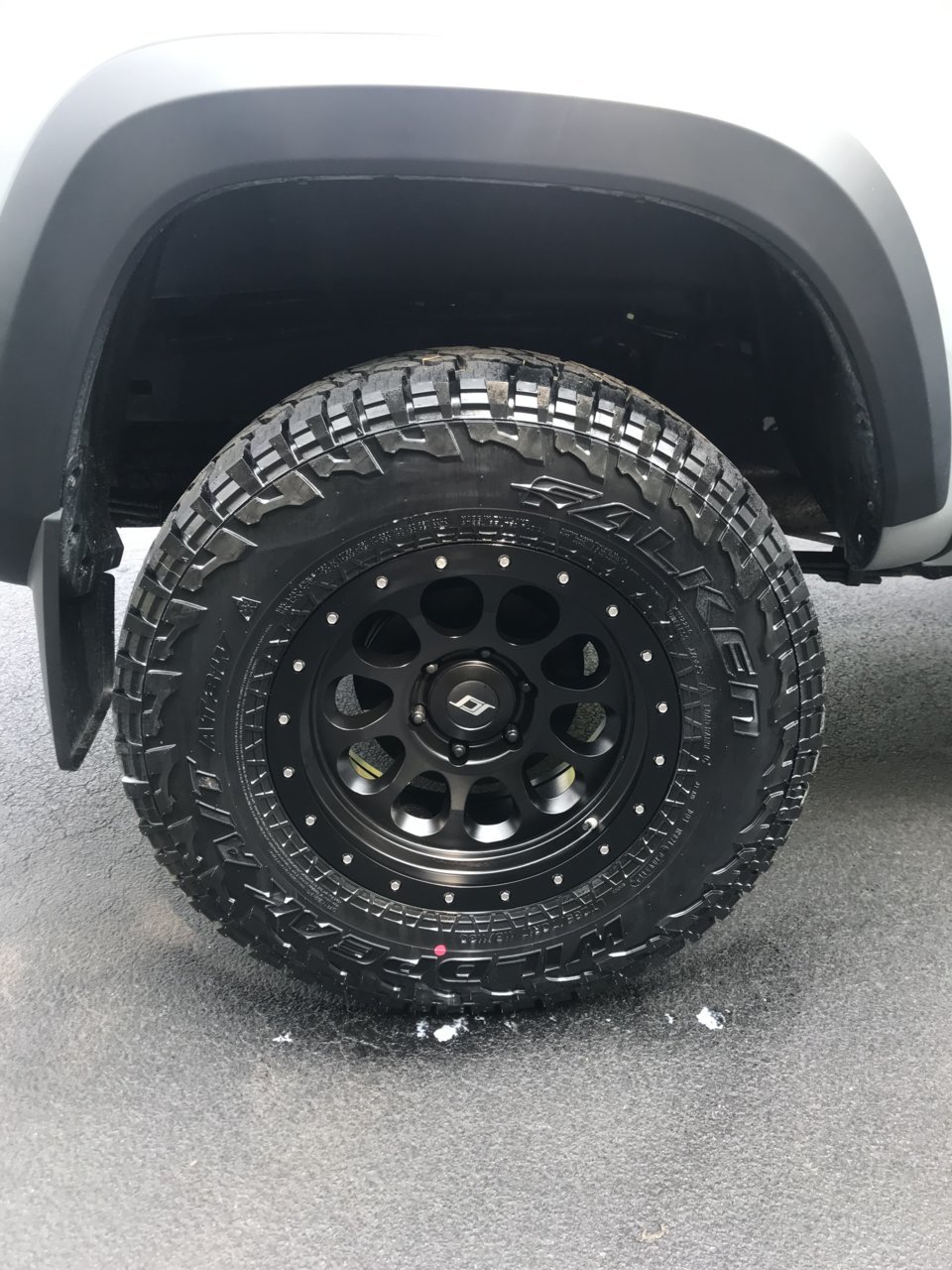

    Just got the truck back today from the shop! I installed a 5100 lift with 887 coils and Deaver Rear AAL from @HeadStrong Off-Road. Tires I went with 285/70r17 Falken Wildpeaks on 17x8.5 Ray10s. I’ve checked for rubbing and haven’t gotten any as far as I can tell. I’ve only begun to test with flex.. did remove the front mud flaps. Overall the wildpeaks are quiet and I havnt noticed much road noise(exhaust may hide it a bit). The truck no longer nose dives when braking and corners better.

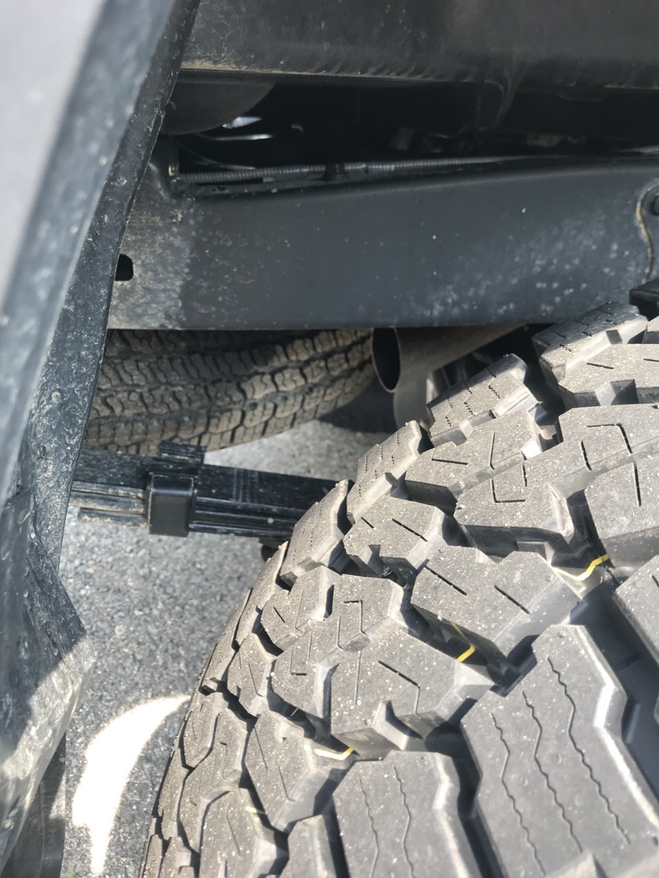

    As for exhaust, I have had the MBRP SS 3” catback and have enjoyed the sound of the exhaust, however there was a nasty drone around 1500RPM that would make the cabin loud. I decided to chop the exhaust after the rear axle for two reasons: first being that living in the NE, the salt corroded my chrome tip in one winter, second that by reducing the total length of the exhaust system, I thought I could change the resonance frequency. I gave it a shot while the truck was down and boy did it make a difference. The exhaust still sounds as aggressive, however there is absolutely no drone whatsoever anymore. You can have a normal conversation again in the cab.

    That spare looks stock. :eek:

    Yeah additional one is sitting in the bed of my truck right now lol

    Lots of guys run stock spares, saves on weight, you can throw it on the front without issues for short distances and not using 4wd.

    Lots of guys probably know better than me, but a 2" difference on trail would make me a lil squeamish. Sounds like OP already has it covered tho.

    Tire shine looks Hella heavy.

    Yeah pic was taken right after I washed the truck and put it on

    Trail for sure. Sorry I meant as in road driving / mall crawling. A smaller spare wouldn’t be a problem on the front in 2wd to get you a short distance.

    been on the fence about MBRP exhaust, and i hate chrome tips so i planned to cut it anyways. now i’m sold :cheers:

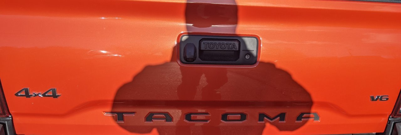

  10. Oct 29, 2022 at 3:45 PM
    Darkmatter
    Darkmatter Active Member
    Apr 15, 2018
    #250600
    32
    I just tried this on my truck with an mbrp black cat back exhaust. You can still hear the throaty exhaust notes in the cab but it seems to me to be toward the back of the cab. The drone does seem to be gone now but is it still obviously louder then stock. I hope this gives a little bit more information for anyone thinking about doing this.

    Ha. That’s the opposite of me. I cut mine so it dumps like that and it’s really loud now. Even added a resonator. I’m going to to ditch the entire thing and do a side exit or something.

    Mind linking me to what you used for the lower part of your tailgate?? Looks good

    My truck is a SR5 inferno. I did a black vinyl inlay from tvd vinyl if I remember correctly

  18. Oct 30, 2022 at 4:11 PM
    #18
    Darkmatter
    Apr 15, 2018
    #250600
    32
    I was out just got home and uploaded an image. I also used vinyl on the chrome badges. PXL_20210129_140807365~2.jpg
