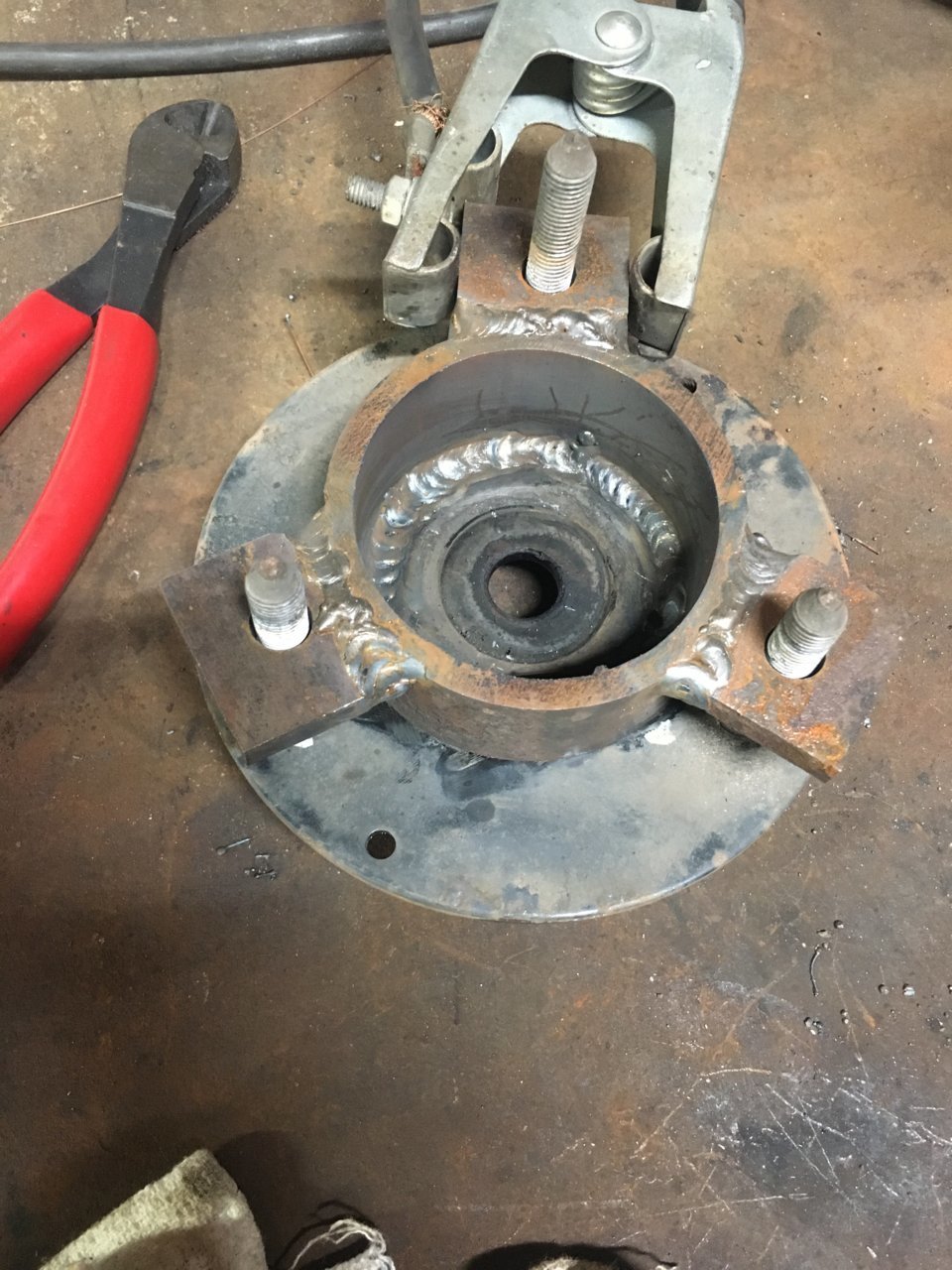

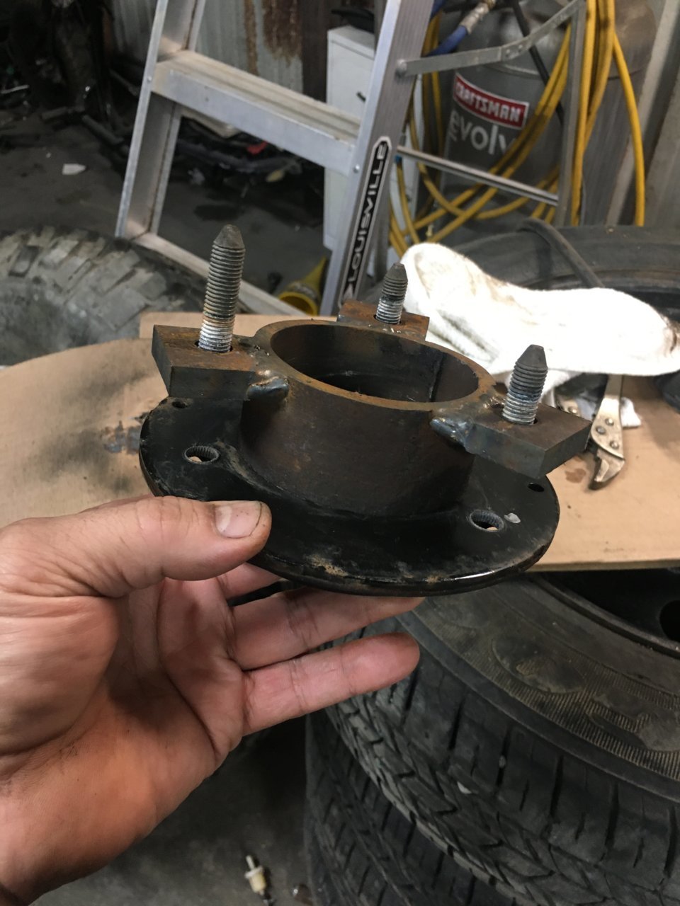

    Lifted 05 5 lug Tacoma
    Custom made front spacers (4” lift) Custom rear add-a-leaf (3” lift)
    I basically lifted my 5lug for free, made my own spacers out of some pipe I cut from an old rear end housing and some 1/4” steel plates I had lying around. Worked out perfect. I welded the pipe directly to the spring hat. I’ll post some pics. And a add a leaf I got from another truck.
