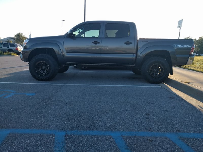

    Newly lifted with 265/70/16s
    265/75/16s will be going in after I burn these into the ground. :D

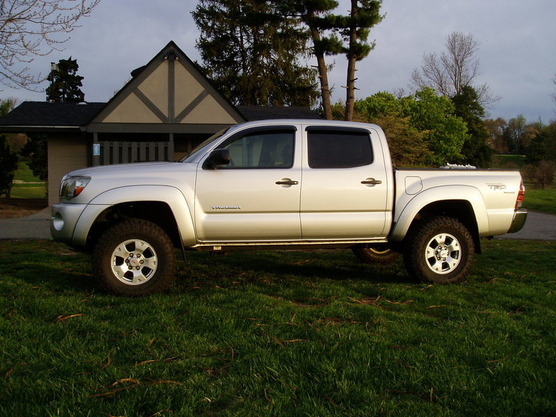

    Here's 3" w/265/75/16's. I had a friends 285/75/16's on it for a few minutes just to see what it looked like. The LOOK was cool. The effects weren't as cool. In a word, RUB.....
    I'm happy with the 265's and can get around everywhere I need to get. I'll probably do 285's next and probably be disappointed with the results.
    Your truck looks good!

    :cheers: Yours too.
    Love to look and function of tall/skinnys too (255/85/16) Just don't like the weight on them.

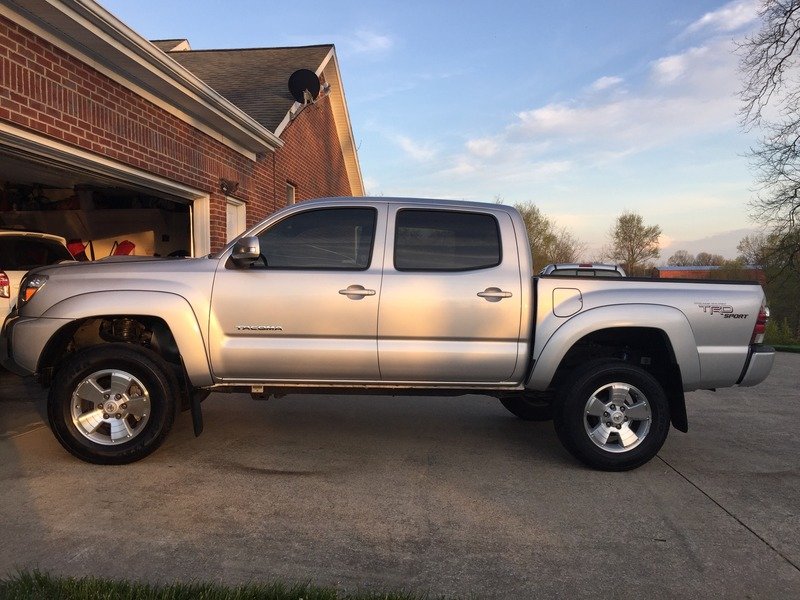

    5100s, 885, stock UCAs, just did the ECGS bushing yesterday sitting on 265/75/r16 Falken Wildpeaks

    :thumbsup: Looks good!

    2" Lift
    265 65 17

    Looks good, What lift do you have on the front and back?
