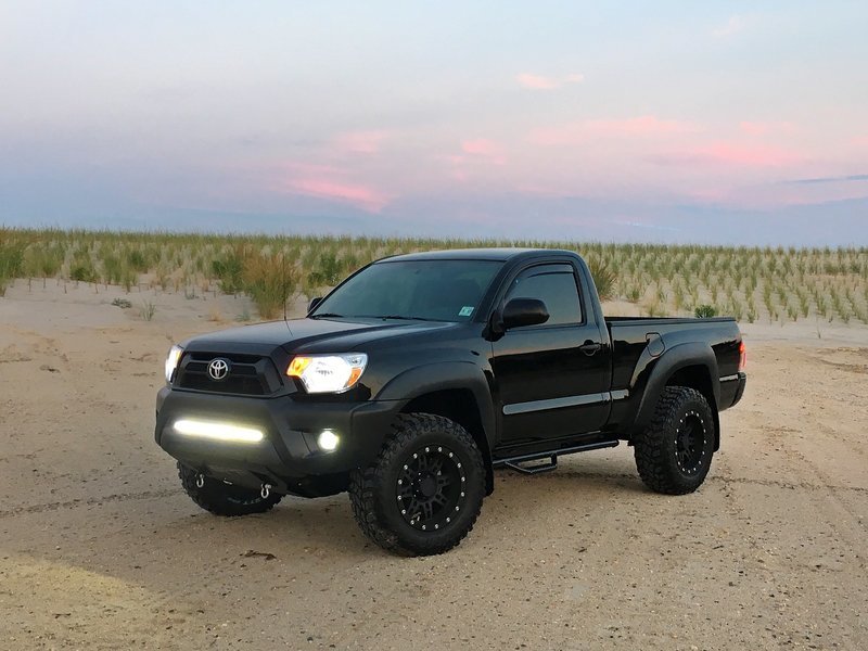

    Bilstein 5100's in the front (1.75 ) and 0.5 shim in the back. 265/70/17. I think its mostly to level it but i think its a good height

    Looks good. Nice picture.

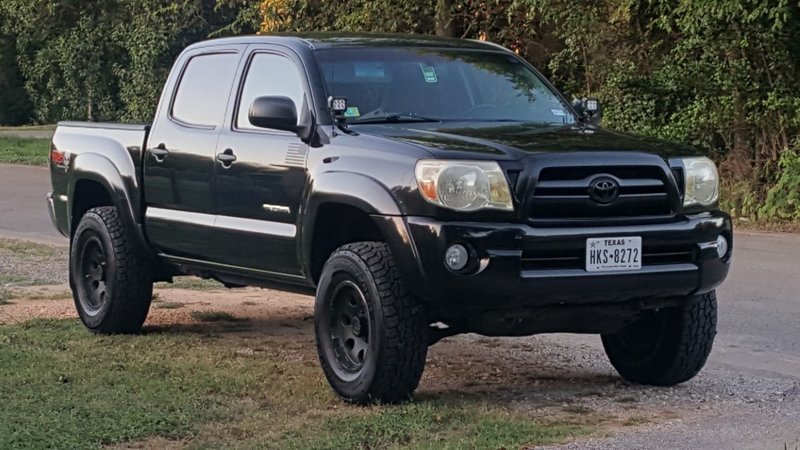

  7. Aug 24, 2016 at 3:23 PM

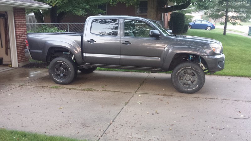

    887's and a cheapo pro comp add a leaf

    Thinking about something like that set up. How does it ride comfort-wise?

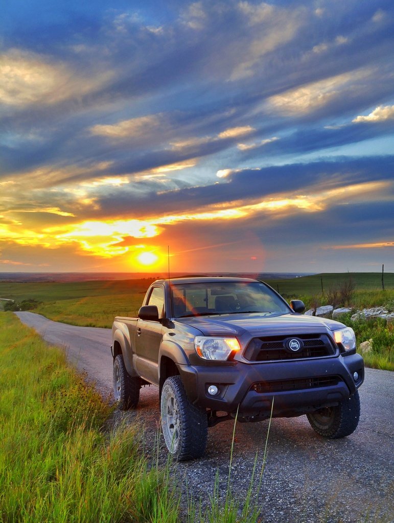

    Just because I love this pic :). Bilstein 5100's all around front at 0.85", Eibach 1.6" springs and 1.5" Icon AAL, 1.25" Spidertrax spacers all around, 265/75r16 Cooper ST MAXX

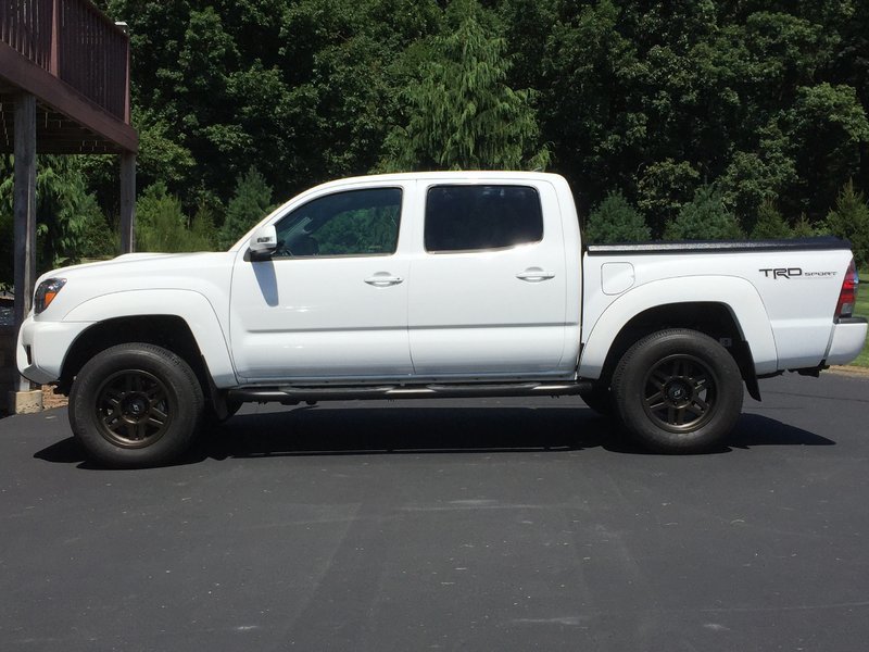

    Bilstein 5100 with 884 Springs. Full audio system. Stealth 6 Wheels. Cali led light.
    Thanks, when first put on About 6000 miles ago I was at 2 inches. Nothing done to back. It has settled and it just looks a little lower. I'm waiting a little longer for my next move to see if I want to aal leaf to the rear.

    Thank u. Honestly i love it. This is my fourth tacoma and second second gen regular cab, and i like the way it rides just the same as the way it drove stock; if not better.

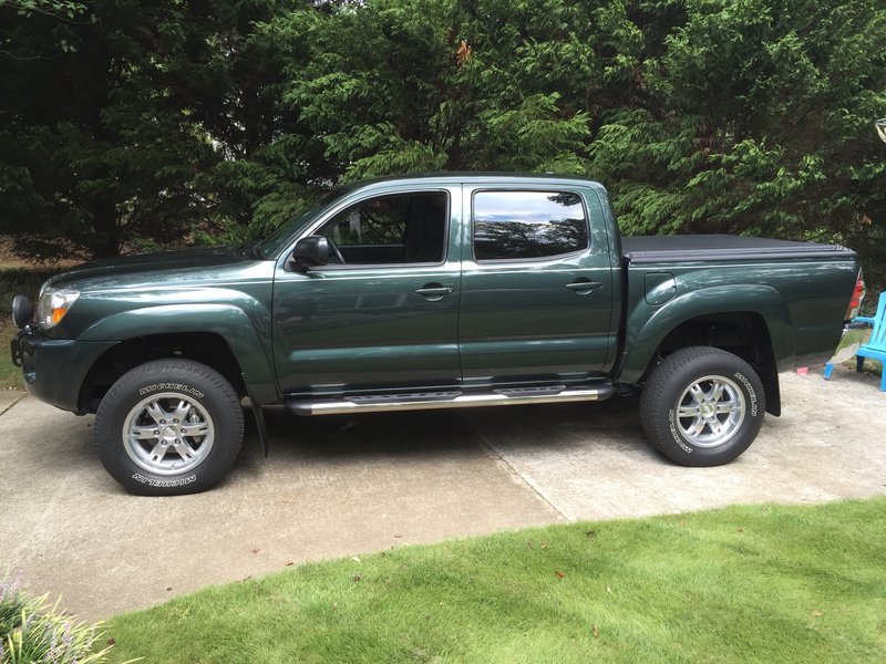

    A little of this and a little of that.
    OME stock lift kit. Full Dakar leaf packs and 885 springs. Tires are 265/65/17 Michelin MS/2's.

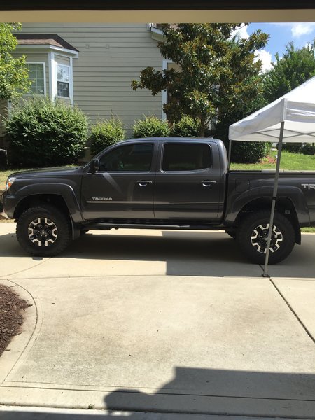

    265/75r16 bfg ko2, 2016 TRD OR wheels, 1.25" spidertrax spacers, Icon 2.5 in front- just above factory setting, Icon 2.0 w/resi custom build for Dakar leafs, top overload removed. Gives about 2.5" lift and 1" rake which I like.
