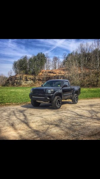

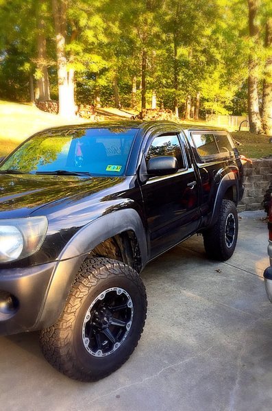

    I like it a lot. The ride is a little stiff but I think that has to do with the fact that I'm a regular cab. I gained about 2.75-3 inches of lift off of them. I like the fact that they didn't break the bank since I really don't off-road that much and when I do it's just simple trails.

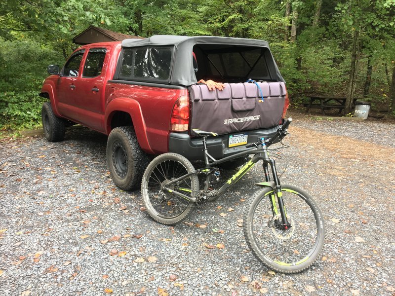

    886 and dakars / 265/70r17 tires

    Somstuff
    Diggin' the Trek too

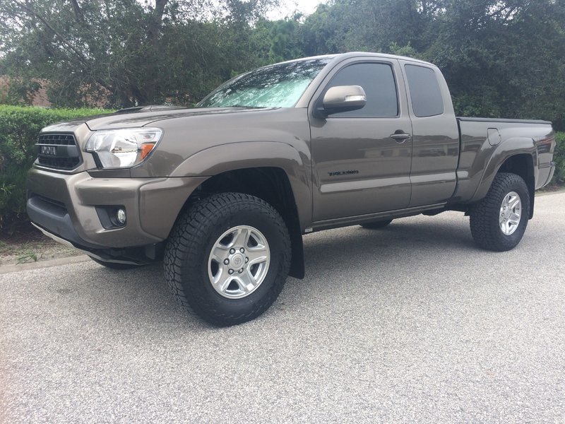

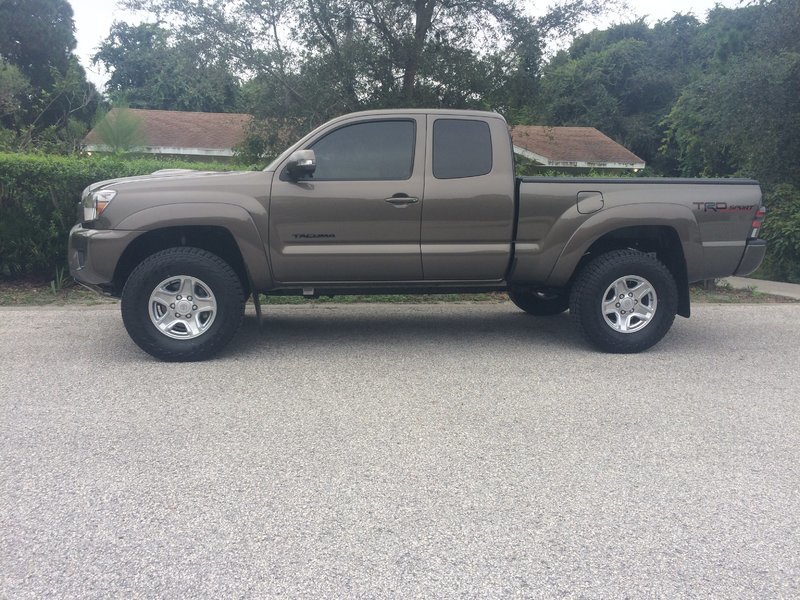

    P265/75/16's with 2.5 Fox Coilovers set at the factory setting. Fox 2.5 Rear Shocks with non adjustable Reservoirs and 1.5" Icon 3 Leaf AAL with overload removed.
    Before Lift Measurements:
    Front-Hub To Fender-20 1/4"
    Rear-Hub To Fender-21 3/4"
    After Lift Measurements:
    Front-Hub To Fender-22"
    Rear- Hub To Fender- 23 1/4
    Lift Results:
    Front=1 3/4"
    Rear=1-1/2"

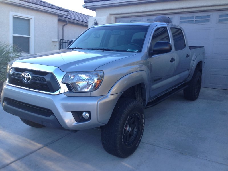

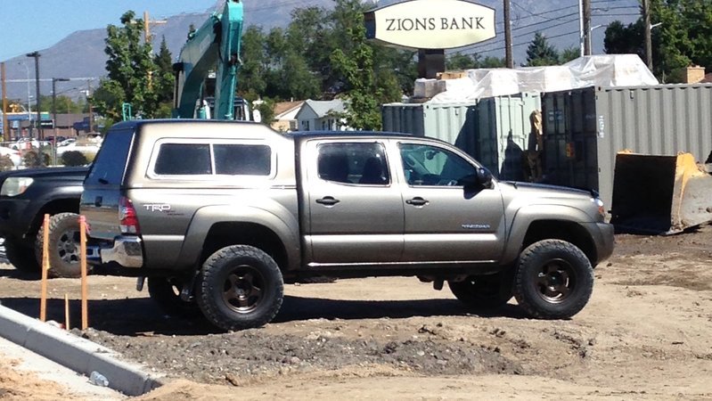

    ADS front and back with Deaver U402 leaf pack. 3" on stock 265/70/16.

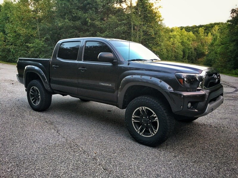

    5100s all around with toytec springs up front and an AAL in the rear.

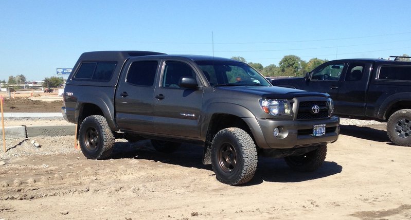

    3" lift Ome with 885 coils and Dakar springs. Swapped out shocks for 5100s

    Did you need new UCA's?

    Stock uca. I did my first run of wheeling today and everything funtioned very well.

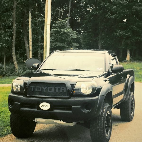

    I've never been a fan of regular cabs but that's a great looking truck!

    Thanks man! I'm trying hard to do little mods at a time. Just bought a camper shell for hunting season for it yesterday IMG_2524.jpg

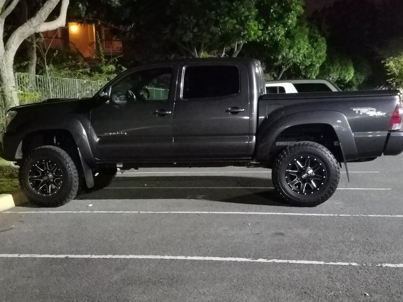

    K&n intake/borla
    3 inch fabtech performance lift
    265 70 r17
    Fuelmavericks

    Duratracs, right? The pic is from the FN Wheels Five star thread.

    Looks like BF Goodrich KM2s to me
