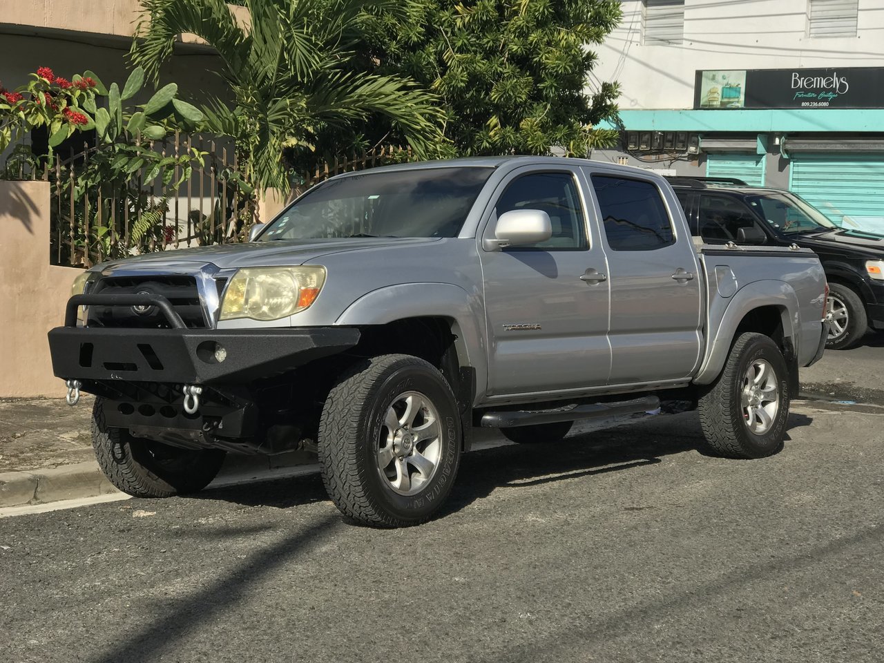

    Bilsteins 5100 set at .085 Rear custom 1" add a leaf 265/70 R17 tires. Custom made aluminum tonneau cover with bike rack. 4x4 conversion with 4Runner transfer case.
    265/70R17

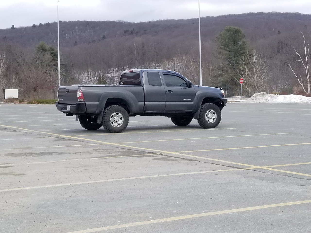

    side note, Berkshire Mall old Best Buy parking lot?

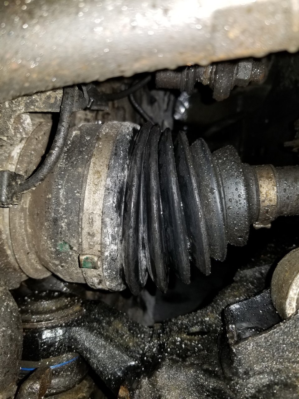

    not sure why yours are touching like that with the 884 coils. I had 885s on my last Tacoma (4x4 access cab 4 banger) and they had a little more space between the fins. The re-clamp should take care of that though

    Haha. you got it! They're "fixed now". Put some miles on and off road over the past 48 hrs and they havent moved. Dont see any cons to this method. Not sure why they were touching either, maybe just a manufacturing fluke. Maybe I would be one of the few that benefit from a diff drop? Whats your thoughts on that?

    I vote no on diff drop. Theres a few pics out there of people going offroading and cracking the diff cause its hanging lower. Also I would be worried bout oil starving it since it may put it at to much of an angle. For me I rather replace a CV boot after a 100k miles then the dif. My last truck the first one went at 120k I think and the second 130k from the boot wearing out. I could have gone farther I just decided to replace the whole thing right when I noticed they were leaking grease. Idk for me I just don't want to go through the hassle of putting it in, the risk of internal damage, external damage, and it could throw off your front driveshaft angle as well.
    Probably right that it this one was just on the far side of the tolerance scale when they made it and that's why it was touching.

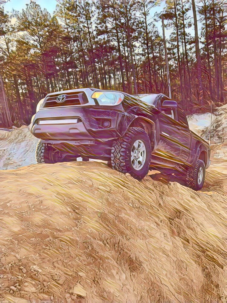

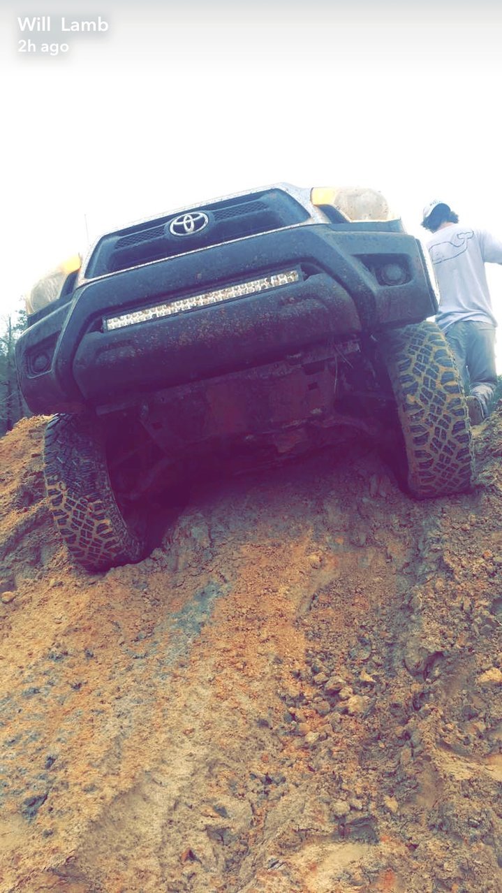

    Full OME suspension 3” with 265/75-16 Duratracs

    @FourBanger99 - love the look of your truck!
    I’m going to be looking up that suspension setup now...

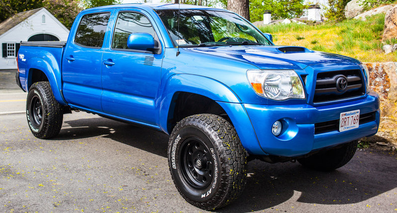

    ATX Mojaves with 265/75 16 Hankook Dynapro ATMs, Spidertrax 1.25" spacers (front and rear), Bilstein 5100 all around up front set at 1.75", Blacked out badges, Pioneer AVIC D3 DVD/NAV Head Unit, K&N Air Filter, Tyger Tri Fold Tonneau Cover, Rockford Fosgate Punch Speakers.
    Wheels are 0 offset but I have 1.25" spacers, lift is 5100s all around with OME 884 coils up front and a Deavers AAL in the rear.
