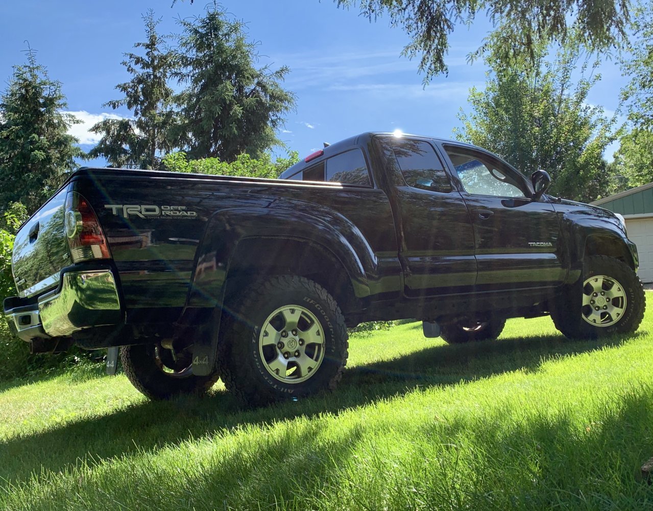

    I did 884’s on my access cab and HAD to do a AAL to get away from the bro-lean. I got about 2.75” of lift in the front.

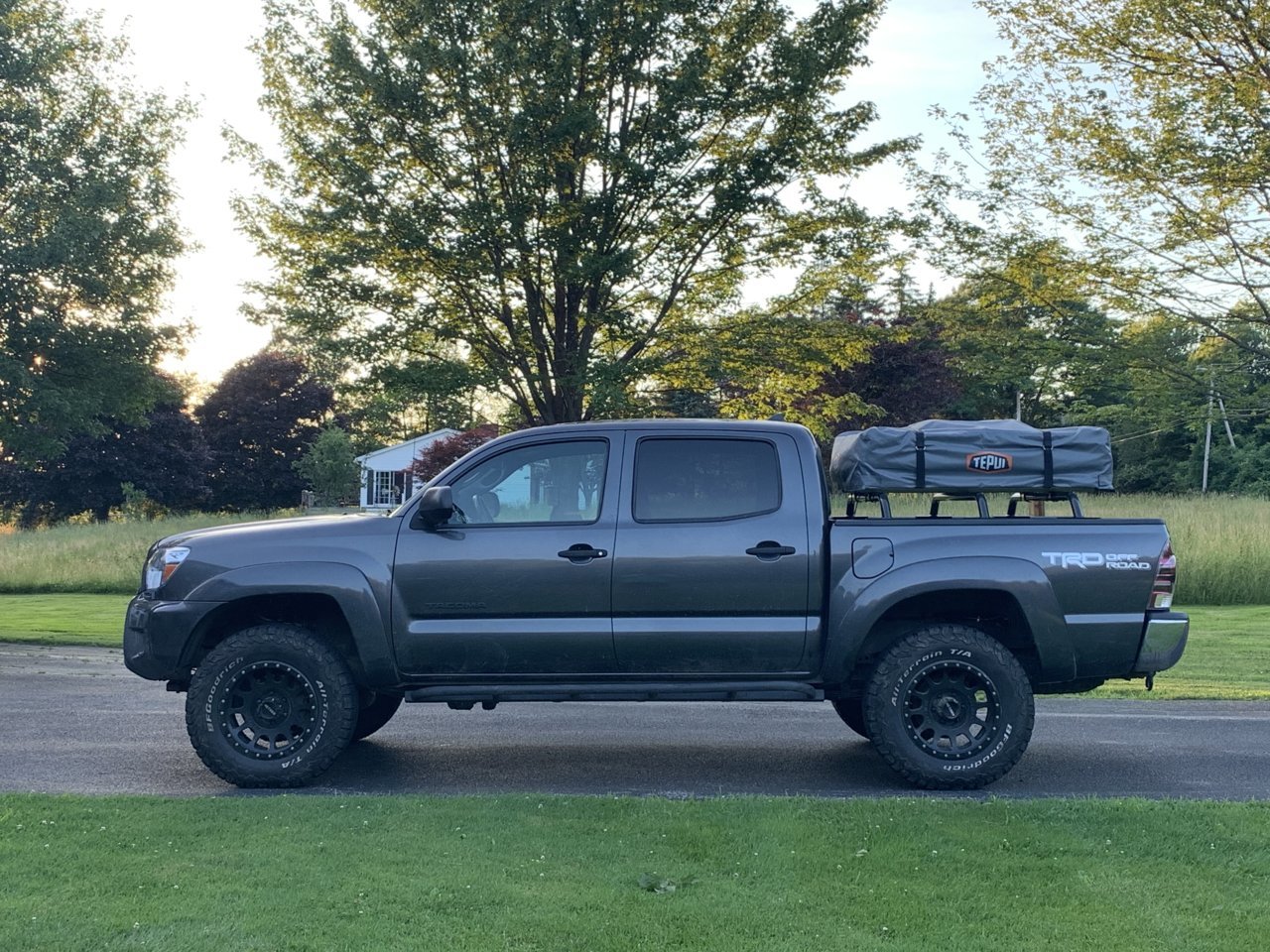

    Duratracs 265/75R16’s on Level 8 MK6, OME 884 with HS lean spacer, Wheelers multi-leaf AAL, AllPro UCA’s, Sumo Springs in the rear. 22” hub to fender fronts, 23” rear.

    What are the specs on those wheels? Looks great!

    Thanks! 16x8 with zero offset (4.5" back spacing) as I like the stockish look by having the wheels tucked in the fenders. They are hub centric wheels and I think they weight about 24lbs in this size.
