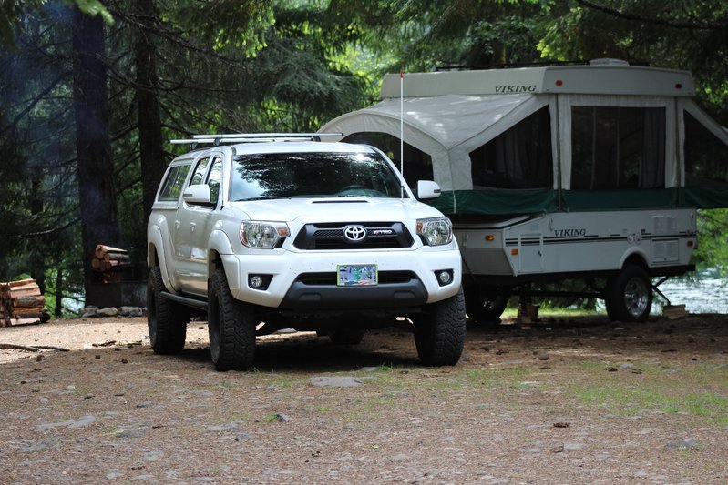

    What type of axle does it have? Is it a straight axle, or U shaped where it bends up - actually lowering the camper? If it's the square-stock U-shaped axle style, it's really easy to flip the axle gaining lift and lots of extra clearance. I flipped mine and got 6 inches of lift, but due to the orientation of the axle, I got more than that in axle clearance.

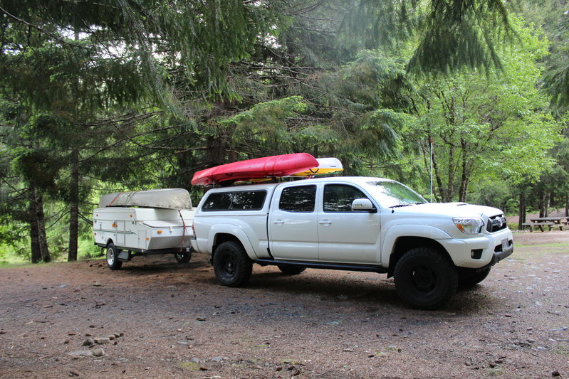

    Mine was lifted when I purchased it. I'll look tomorrow for you to see how it was done and tire size.

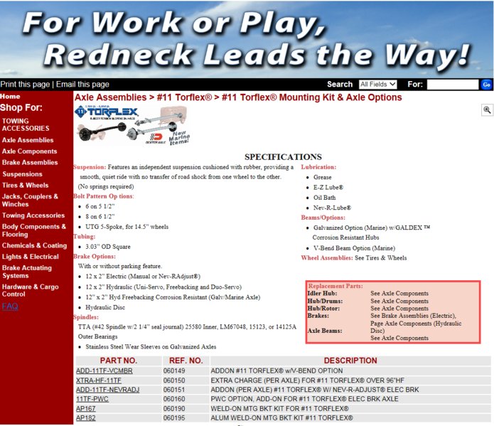

    Try Redneck Trailer Supply in Tampa. They'll either have what you're looking for or can get it. www.redneck-trailer.com
    You can order an axle and get the bolt pattern to match the Tacoma. You'll also want a torsion axle to gain ground clearance.
    you'd probably spend 300 -400 on a new axle.

    Last is a google pic of my model. You can see at factory, the axle is located above the springs. Mine has a spring over, which puts the axle below the springs for lift. Hope this info helps.
