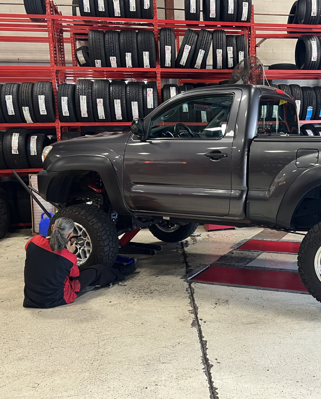

    Trust the process added hood scoop

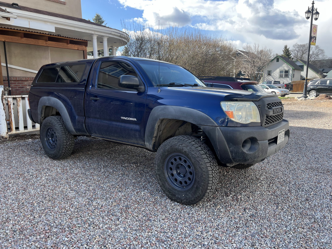

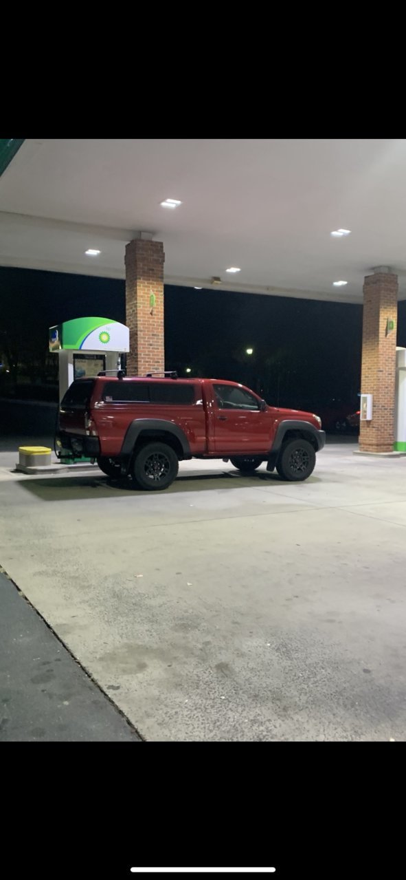

    @jeff1304 I just installed that kit on my 07 Reg Cab. I love it. I also did the Icon AAL in the rear.
    rcn, Bikinaz, 4x4Taco2012 and 3 others like this.

    That does look good did you end up going with a lighter spring? Also looking at the dobinsons mmr setup which looks like it could be a good option and has plenty of options for adjustment.

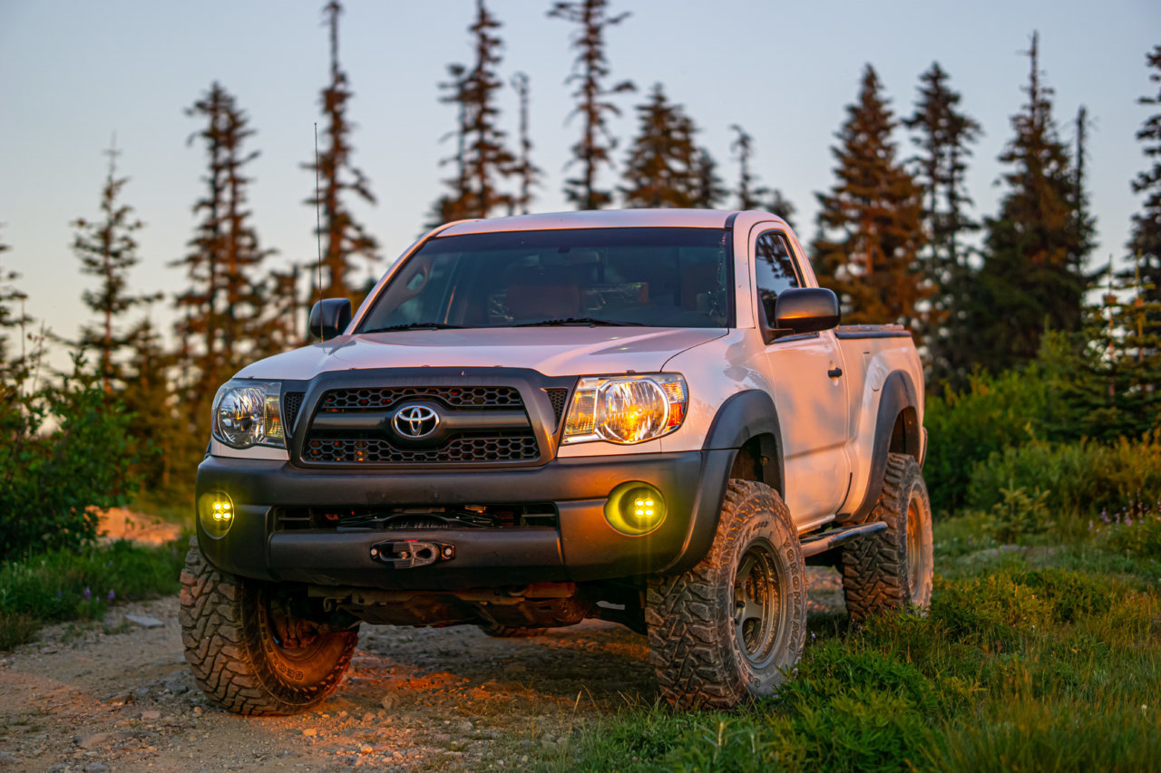

    Hey Nightshade, how do you have that CB antenna mounted? I have mine mounted on the rear of the truck and my SWR is a little higher than I want....Fiberglass shell/plastic bed
    = bad ground plane...so I'm planning on moving it to the front of my truck at some point.

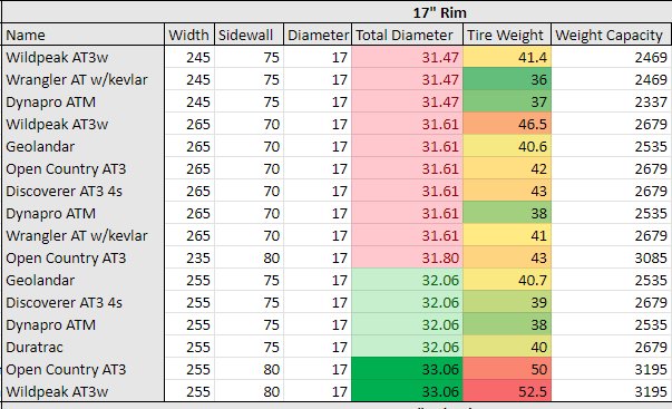

    Hi all, new here. I'm rocking a 2.7 5spd with 4:10's. Maxxis Razr AT's in 285/70/17 117t are 32.6" and 43lbs a piece. On 22lb wheels this would total out to 65lbs per wheel/tire, would this be manageable? Or stick with 265/75/16's in 116t? Thanks

    That sounds more completely manageable from a weight perspective actually. The Razr AT's are surprisingly light for their size (probably due to the P-rating). 65lbs per tire is solid, and around my stock weight for 16" steel wheels + 245/75R16 Wildpeaks.
