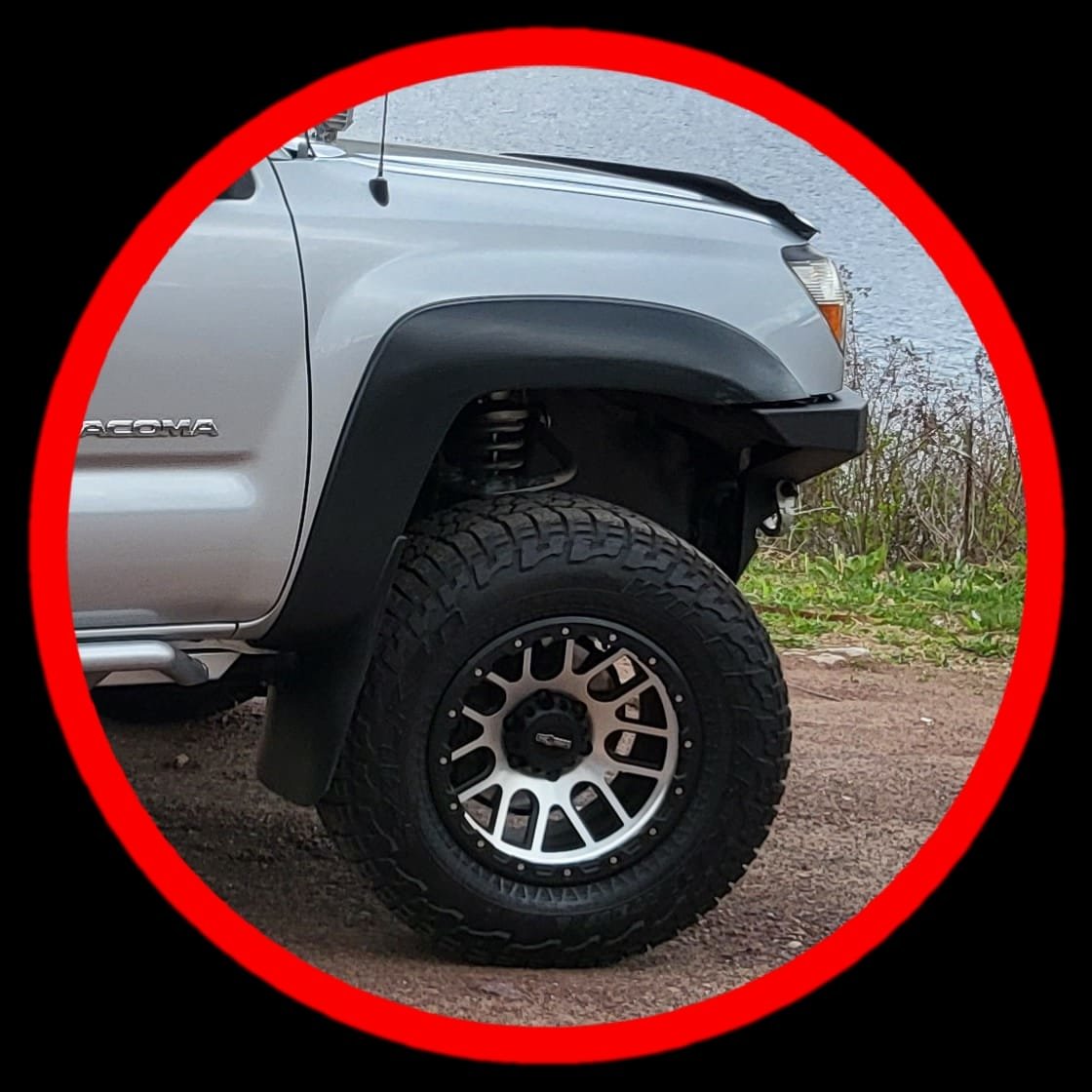

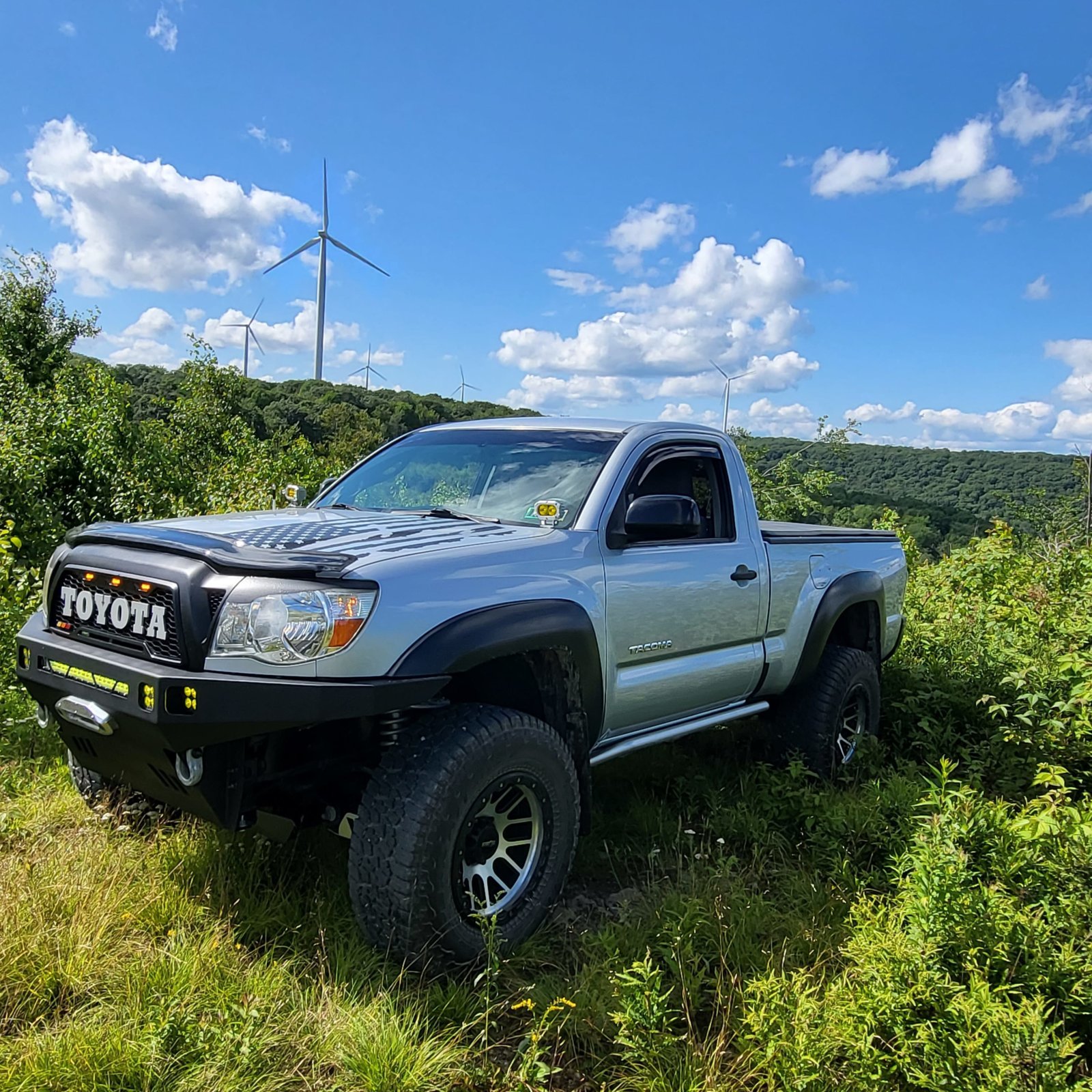

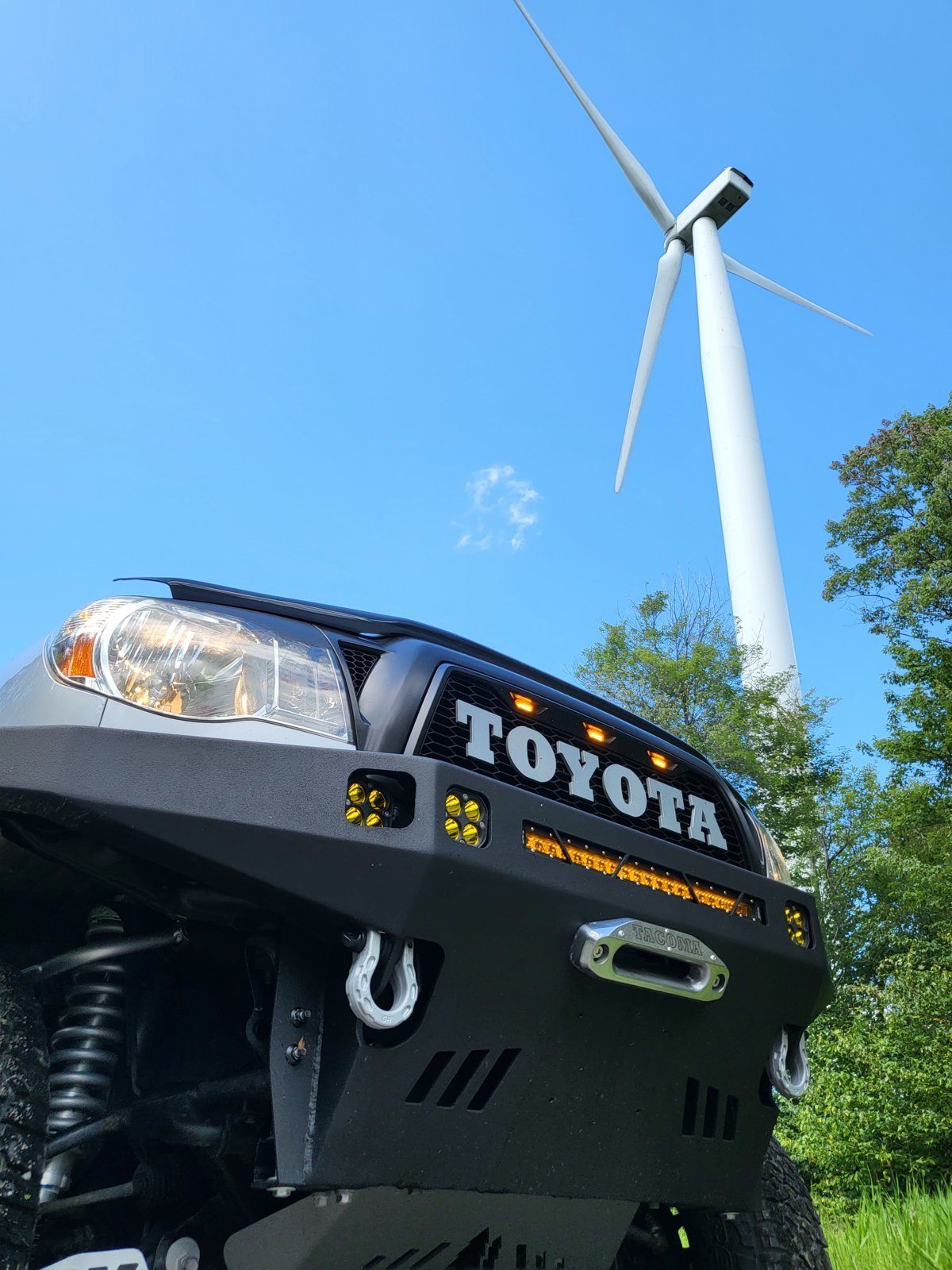

    2 "- 1" lift 265/75 on the 2017....275/70 3" toytec lift and 1" body lift, coastal offroad bumper
    20230730_153755.jpg IMG_20230701_154347_228.jpg moved up to 285's IMG_20230730_173847_373.jpg

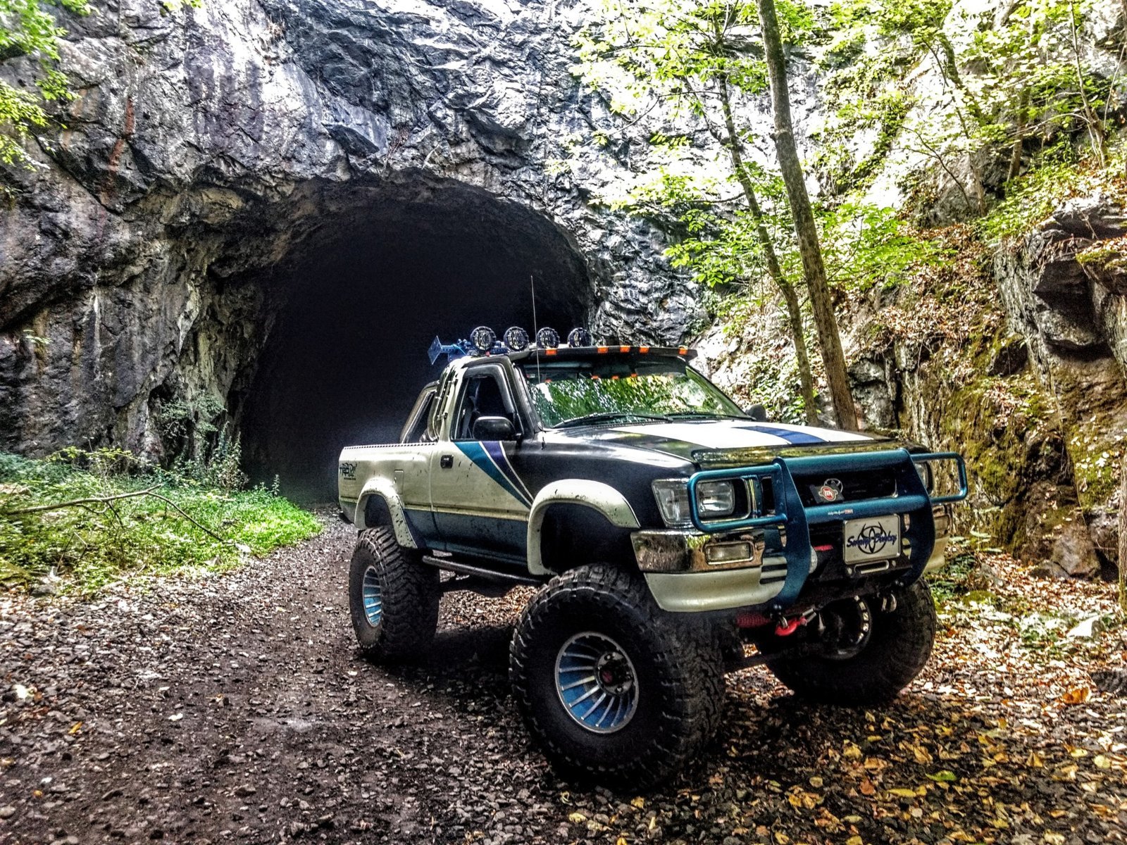

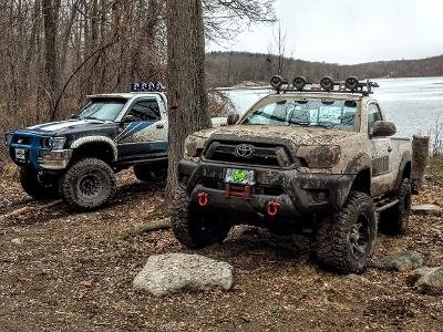

    A couple regular cabs wheeling!!!

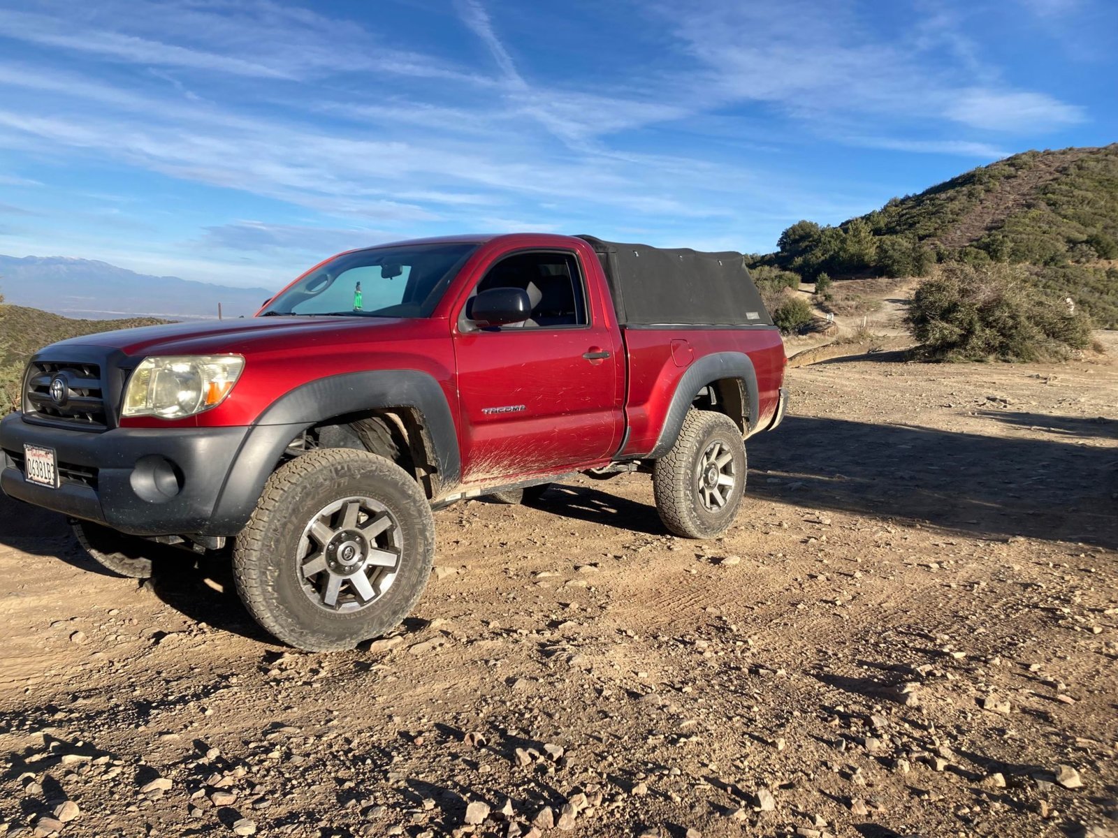

    Finally put on my 255/80r17s, Falken Wildpeaks on 4Runner wheels. No rubbing with a Fox 2.0 lift up front (about 2.25" on our Reg cabs), even flexed with diagonal tires off the ground. The light weight of the truck means I'm not able to use the full suspension travel in the front, though. Super super happy with this. Night and day difference compared to my old 245/75r16s lol
    If anyone's interested these E-rated tires chalk test to ~28 psi front/25psi rear when cold.

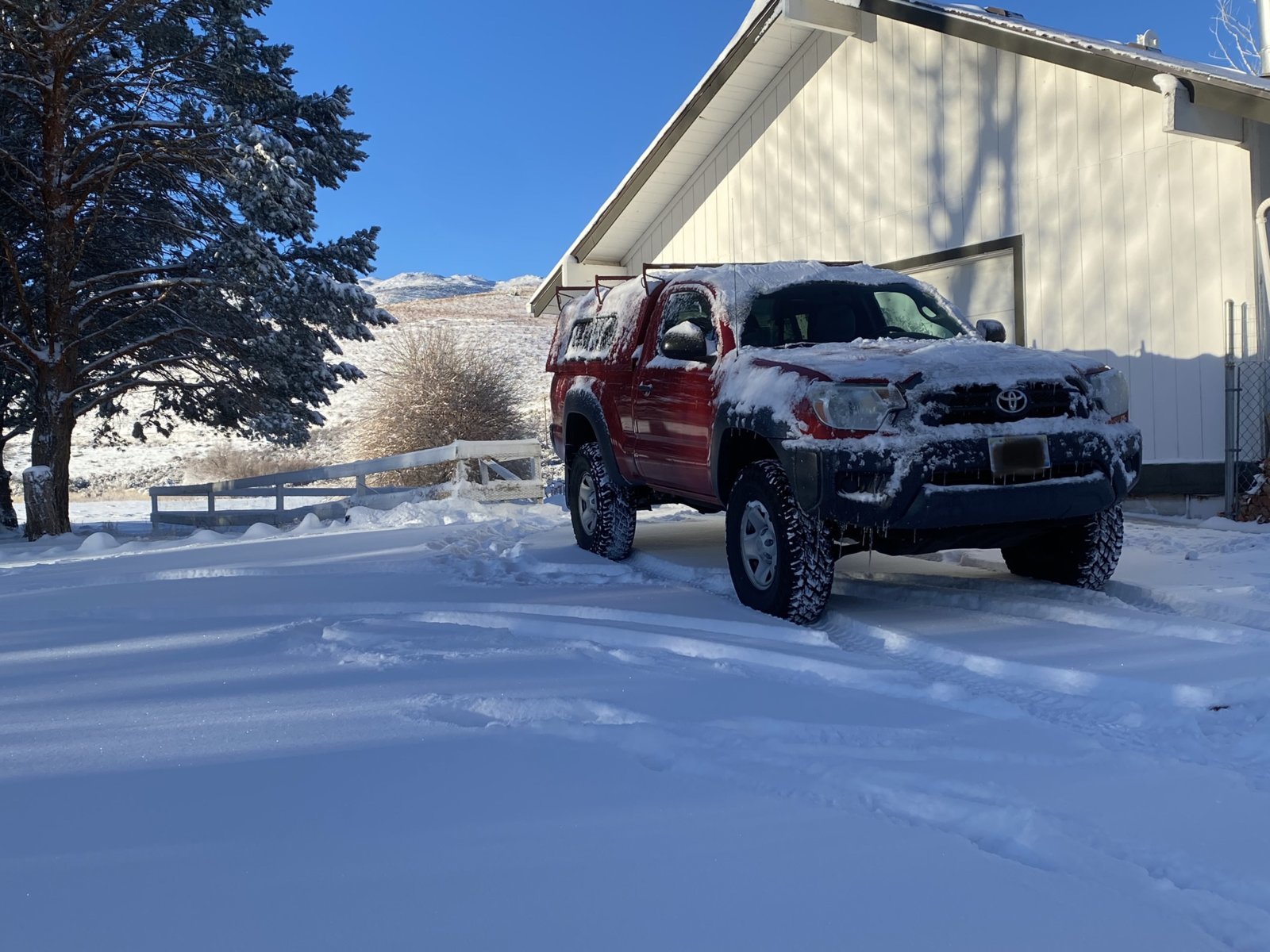

    255/85 r16 cooler st maxx’s did well in the snow! Saving up for a regear, the auto and 4.10 is a tad under geared I feel.

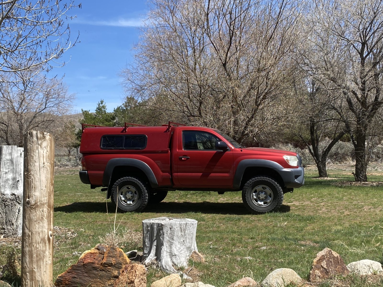

    A post to keep this thread alive. I re-geared to 4.88’s. So far, so good.
