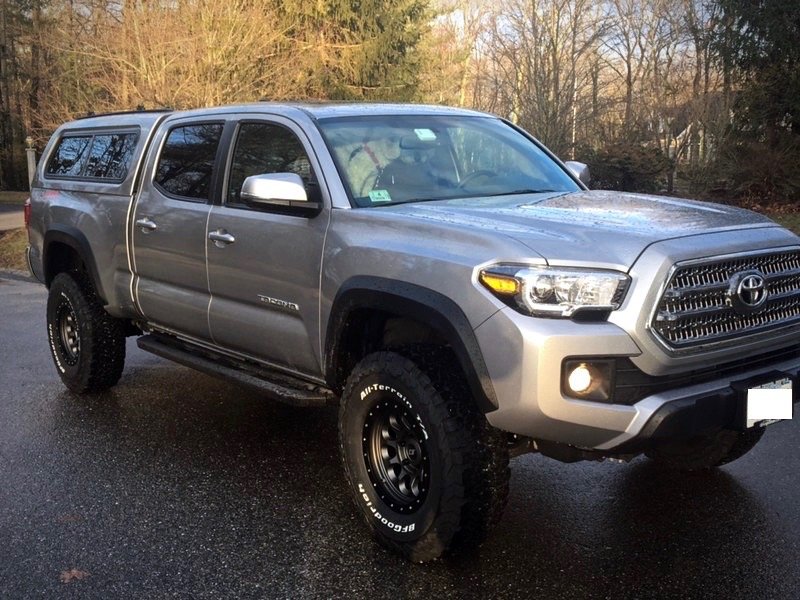

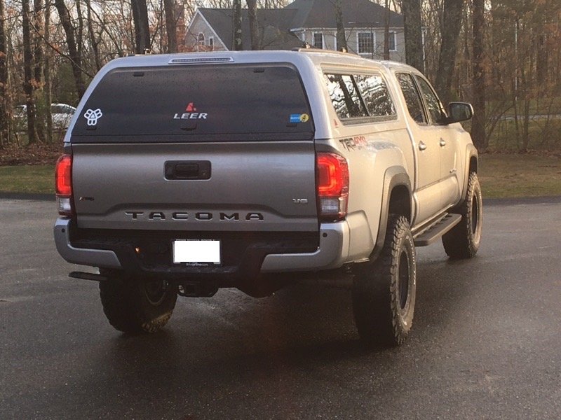

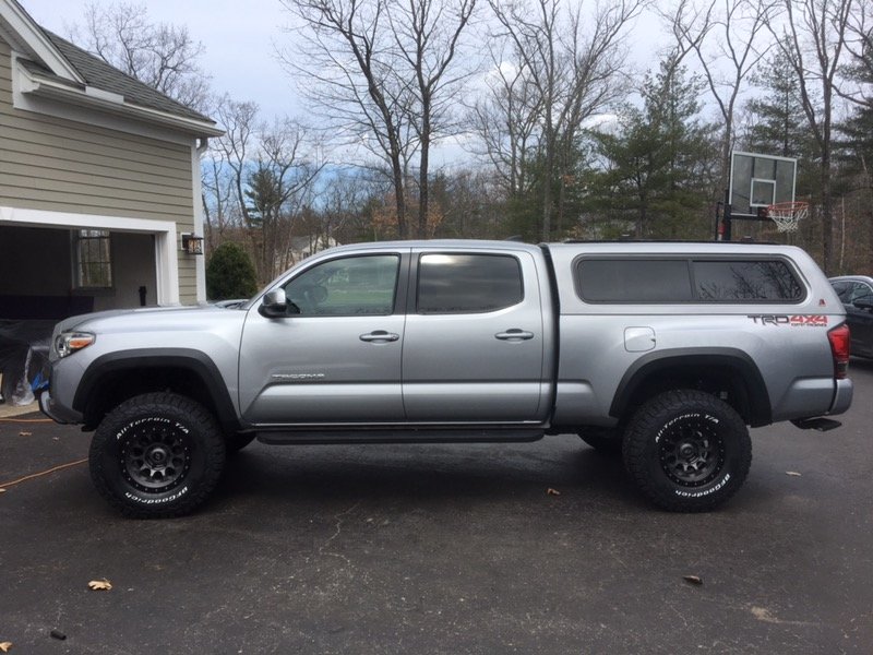

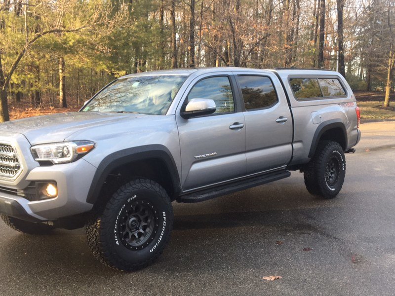

    Hey all,
    After a year of ownership I finally took the plunge and decided to lift my 2017 TRD/OR Long Bed. Did it with my buddy over the weekend who's mechanically inclined. Kind of a PITA, but fun at the same time.
    Here's what we added:
    - Suspension bought from Headstrong - Billstein 5100's all around, Dakar Leaf Pack (medium Duty), OME 888 Coils Up Front.
    - Taco Lean spacer on front driver's side coil.
    - Replaced the needle bearing thanks to East Coast Gear Supply (no vibration!)
    - Light racing UCAs
    - Brake extension lines
    - OME carrier bearing drop bracket
    - SC10 Rays in 16" (man those are tough to buy!)
    - BFG 285/75/R16s

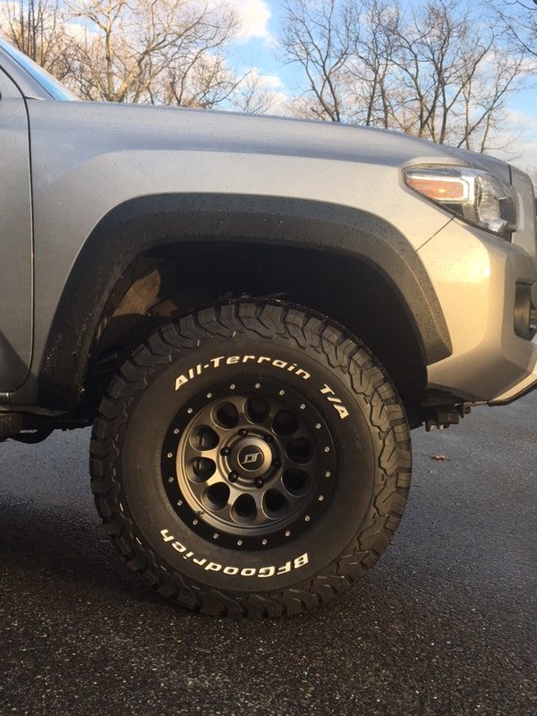

    Was there rubbing? Initially yes. After the alignment - NONE! I couldn't believe it. Jacked the steering wheel both ways on tight corners at various speeds and breaking and not one ounce of rubbing.
    Road noise? Nothing audibly different that the prior setup I was running, which were Falcon Wildpeak AT3s.
    Did I regear? No. Haven't gone on extensive road trips, but so far it seems to drive fine and no noticeable difference compared to before.
    How does it ride? Honestly, it's not far from stock. I can't really tell the difference. Wife and kids approve which what I care about most.
    Between the lift and bigger tires, I gained close to 4" of lift. Couldn't be happier with the finished result!
    Next up I plan to install the heritage grill and black out the emblems.

    So no trimming or CMC? Also why the switch to BFG’s? Looks great BTW.

    That looks perfect.

    No trimming or CMC. Couldn't believe it!
    Always loved the look of BFGs in 285s.

    Mind if I ask how much it cost ya out the door with parts and install?
  11. Apr 4, 2018 at 6:44 PM
    TimmyC
    TimmyC [OP] Well-Known Member
    Jun 25, 2013
    #106985
    140
    Tim
    Central MA
    2017 TRD OR DC Long Bed
    Billstein 5100's, OME 888 Coils, Dakar Medium Duty Leaf Pack, SC Ray Rims, BFG K02 - 285's, Leer XR100 cap, Topper EZ Lift System
    Lift kit from headstrong off road was $1650
    Needle bearing replacing with tools from East Coast Gear Supply was $193
    TPMS Sensors were $248 (ouch)
    BFG Tires were $1,000
    Rims and lugs were $950, which included balancing and 4 wheel alignment
    Labor to install with my buddy was a nice mexican dinner and a bunch of margaritas

    45F2189D-3CC7-4603-96D3-CCDBD6D4AA87.jpg Have you let it settle yet, i got the same setup up front except 265/70/17 and it settled quite a bit. Im 21 5/8” from fender to center of wheel

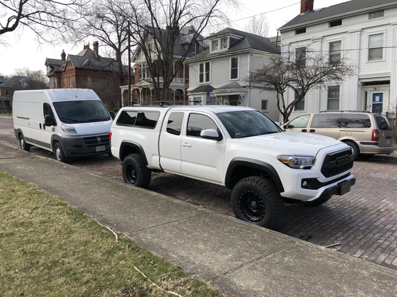

    I have the same exact suspension setup on my 16 OR Acess Cab. I didn’t rub at first either, haha.
    Now I rub hitting inclines at speed and full lock on inclines.
    *Edit: I’m on 285/70r17s.

    Interesting and nice looking rig! Yeah, it's only been since Sunday that it's been lifted, so I'm sure it's going to settle some. Though your front doesn't seem to have much of a rake. How did you deal with your rubbing? Did you just have to trim some of your fender guard?

    Nice! Interesting, yours definitely settled quite a bit in the front. You have OME 888s up front?

    Yes with bilstiens stock uca

    I haven’t done anything about it yet honestly. It’s very minimal and hit and miss.
    I’m going to let it get some good marks on either the cab mount or fender plastic before I cut. Still can’t even pin point exactly but I’m thinking it’s the cab mount.
