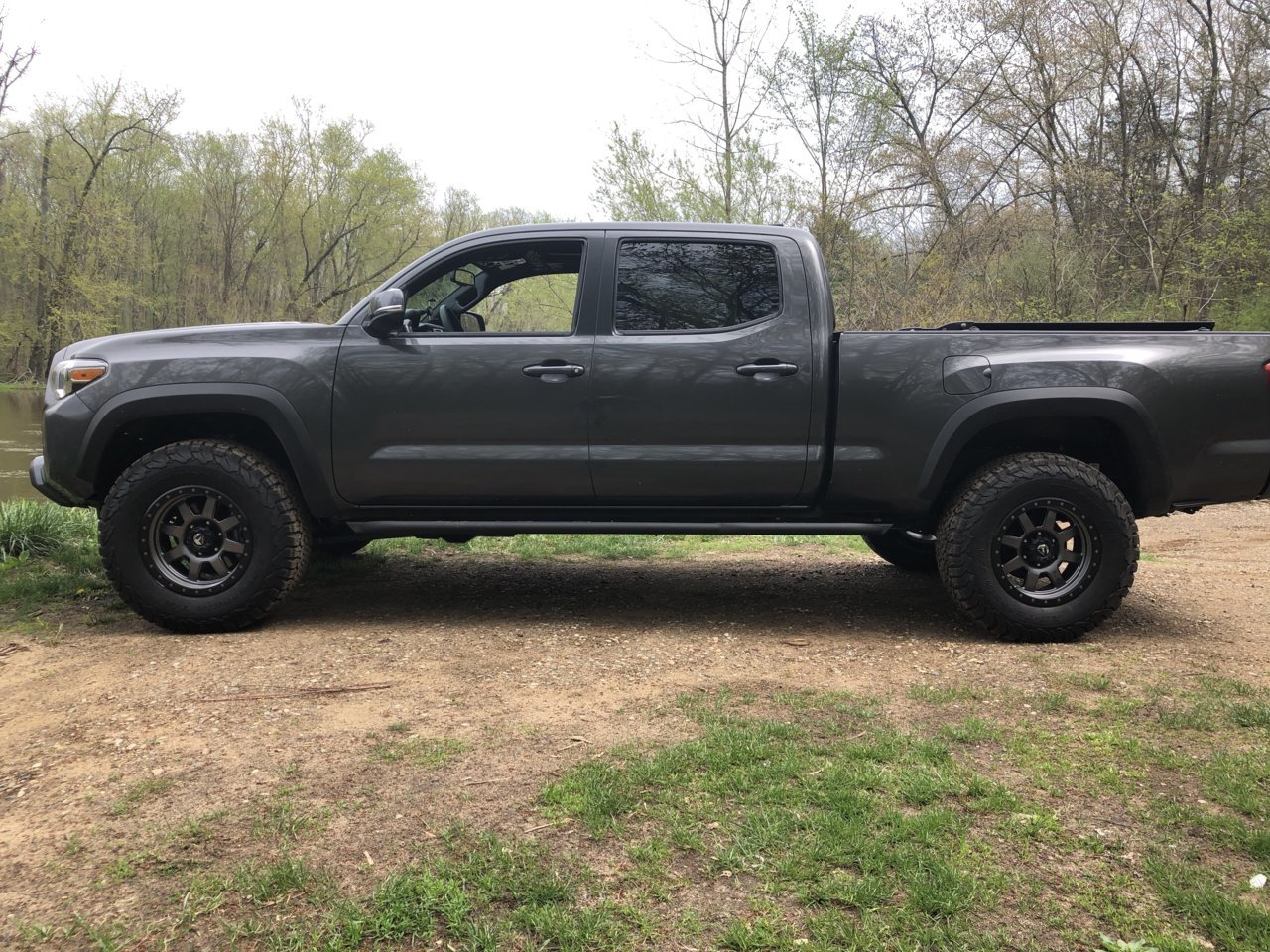

    Just my build. 5100 at 1.55 front. Add a leaf rear. 265 75 16. 5.5 back spacing rims. 28BFE5AE-68C5-4CB6-8F51-69BA504A112C.jpg

    Are you getting any clamshell bushing vibrations with the 1.55'' setting?

    I came from an 08. 3 inch lif. Same tires. No problems with hauling the usual stuff up to 800 lbs. much better ride than stock. It’s a manual. So I can control it much better

    No vibrations. Just silky smooth. Remember I do not have spacers on the front. The greater offset has given me a better ride and less wear on the front

    Cookie cutter Tacoma, 888/Dakars/LR/ECGS/Sliders
    Trucks look great. Timmy/Cruxx, wondering if you guys have different gen 5100's to explain the large height difference? Where are you height wise now that you've settled out after a month Timmy?
