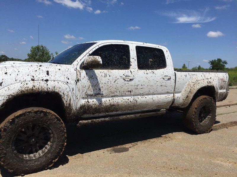

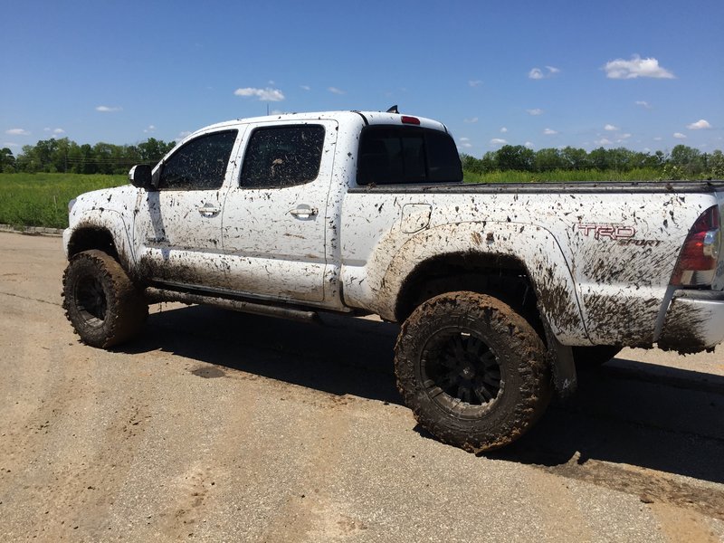

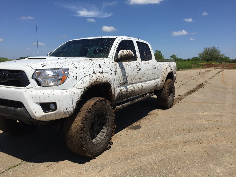

    attached a few pics of a light mudding i did after i finally found one too many scratches after a car wash and gave up on it being a pristine new truck. this was the only time i really ran it off road and it wasn't much. eventually we will se what it can do. with no locker i might add. thx Jordan

    It sounds like you threw some weights off your tire having fun. So you might need to have your wheels rebalanced. The larger a tire gets the harder it is to balance.

    checked my tires. front left tire had a stack of weights when they installed them, and now nothing. taking it in tomorrow; thx bro...you the man!!
