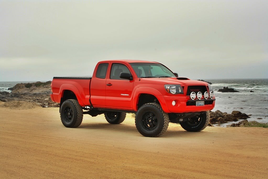

    if 4wd then RCD kit like mine

    3'' toytec lift springs wrapped around 5100's. Deck plate mod. TRD seat belt pads. JL audio amps /subs and Alpine speakers. Diff breather mod. Working on a custom rear bumper
    That is a nasty ass truck!!!! Soooooo nice.

    thanks, yeah your only option being 4wd for 4" of lift is the RCD 4.5" lift kit
    they don't make a 1st gen kit... as far as i know

    Why did RCD make that kit with the butt so high? Are they blocks or leaves? For drop bracket though, RCD did a great job.
