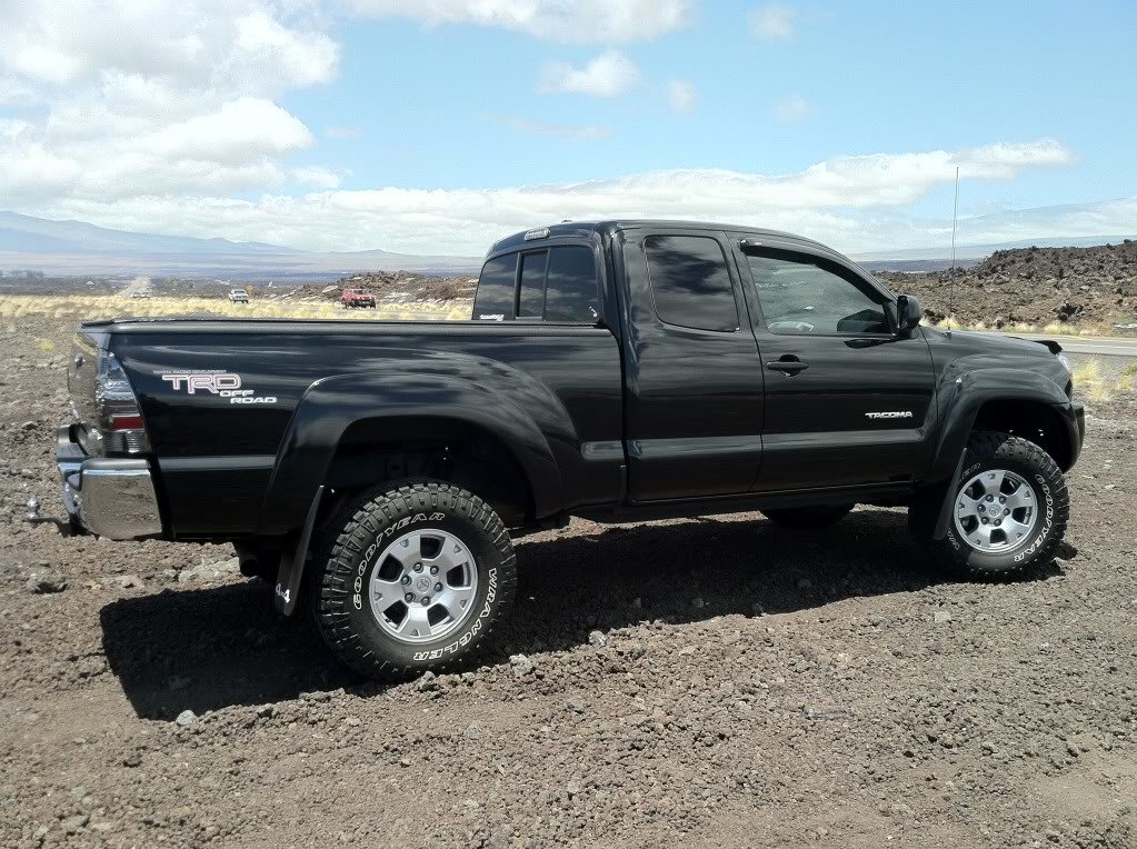

    edit: here's mine with a 3" lift and 245s i think

    I'd step up to a bigger tire size. 265/75/16 is a good size for a DD that sees some offroad use. I have 265/75 Duratracs and I'm not rubbing anywhere. 245's, in my honest opinion, would look too tiny with a 2.5''-3'' lift.

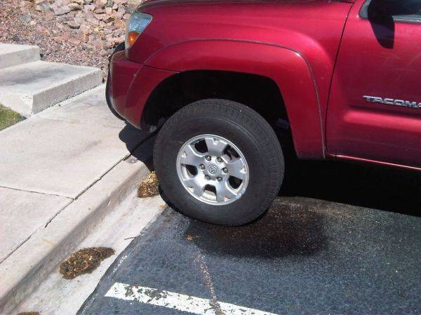

    I just "lifted" mine 1/2 inch up front with a taco lean tp spacer on each side when swapping out the tokicos for the TRD bilsteins that never went on the 05 because it got the 5100s. This one came with Falken Rocky Mountain 245/70/16s and they look skinny compared to the 275/65/18s that were on the 05 for sure but this time I'm stayin with the oem 16s and bumping up to 265/70/16s and calling it good. The 265s will look better but these Falkens have 50k treadwear rating and I'll be using them up first. If you are lifting more than .85 with the 5100s then yes it's gonna need some fatter cleats. I'm just stayin a bit more practical with tire costs & gas costs on this one but it is very hard to not go more, lol. Here's my skinny little good for mpg 245s....
