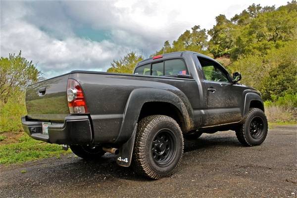

    Debadged, took off front mud flaps, prevent tailgate theft mod, Magnaflow 18" muffler, Bilstein 5100s front and rear w/ front @1.75, wet okoles, plasi dipped front emblem, weathertechs, scangauge, toolbox, Bed pocket lights, BHLM, T1 eyelids, BAMF sliders, Bruteforce Fab rear bumper
    Model Year: 2011 Reg Cab
    4x4 OR 2wd: 4x4
    LIft Installed: Bilstein 5100s @ 1.75
    Wheels Installed: 16x8.5 MB 72s 4.5 BS
    Wheel spacers?: No
    Tires Installed: 265/75/16 BFG All Terrains
    Plastic Triming need: None
    Body Mount Trimming or Rubbing: Zero
    Picture If You Have One: [​IMG]
