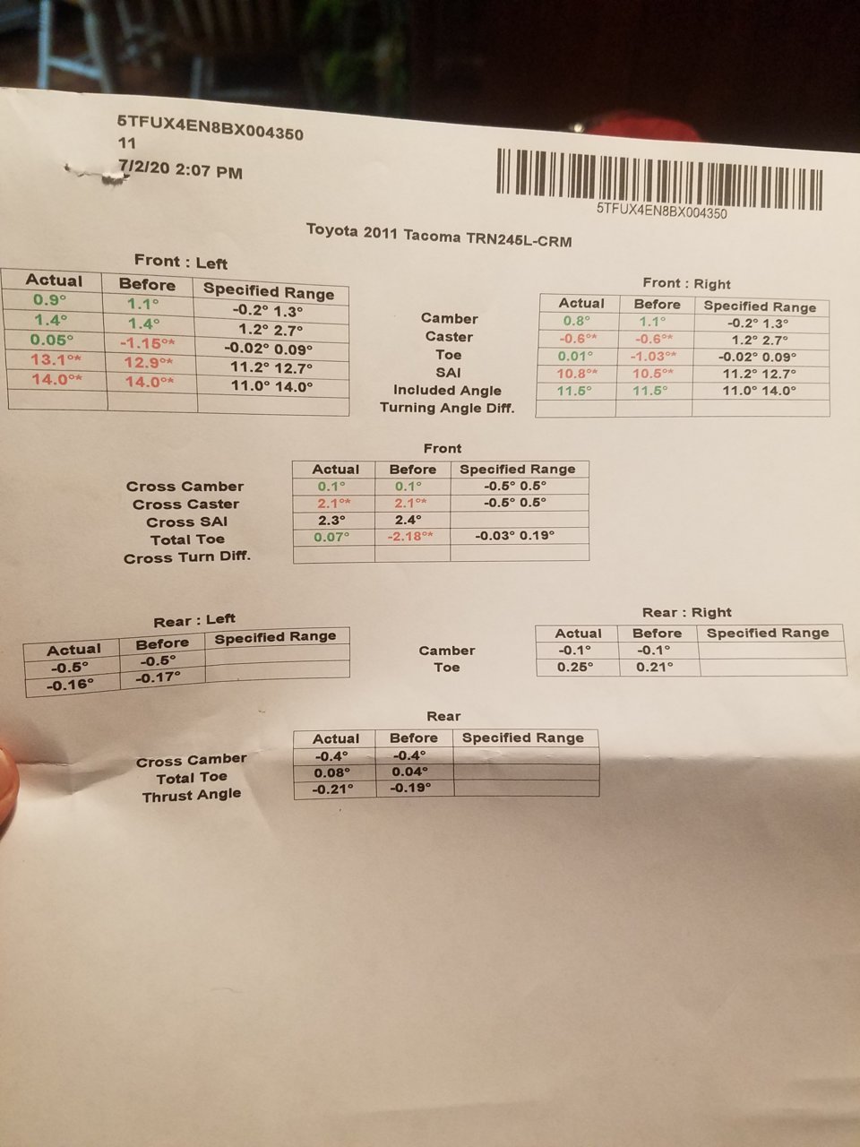

    Hi all, 1st time posting.
    Just got a 2011 access cab sr5 with 32,000 miles. I lifted it myself with 5100 toytech with coil over, put on new rims & 285/70/17 wildpeaks.
    Just had wheel alignment done and it feels like I'm all over the road. It pulls to wherever the dip in the road is.
    Also feels little shacky, like i feel every small bump in the road.
    Wondering if my alignment specs are any good.
    Any help would be greatly appreciated

    While the numbers look ok, curious what they put in the machine as the vehicle since the specified range for caster is incorrect. Also if you still have factory ucas I seriously doubt the achieved 3* of caster.

    This...No way you have a caster# that high with your lift and stock uca.

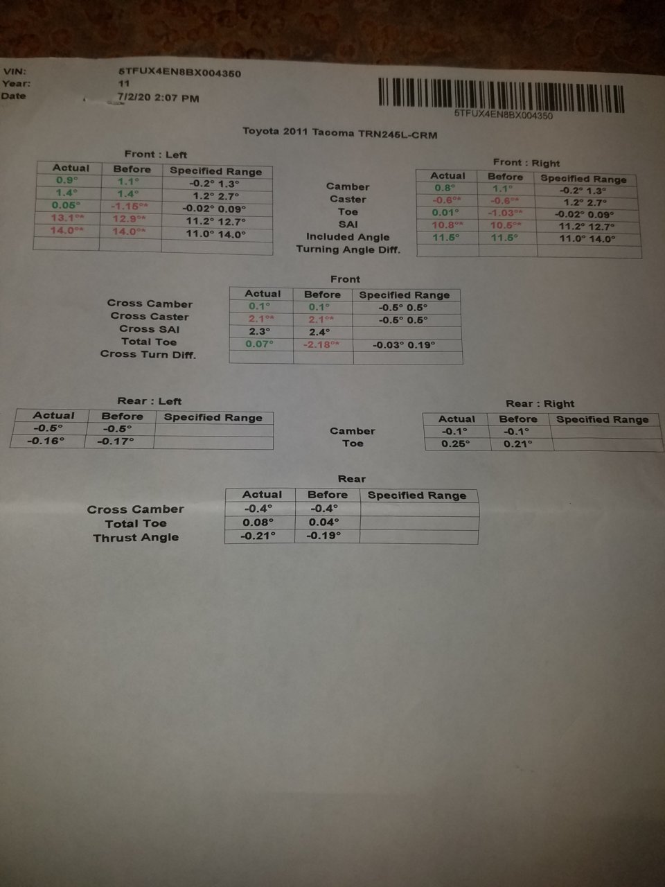

    Omg, that sheets for my envoy wheel alignment, im a nub

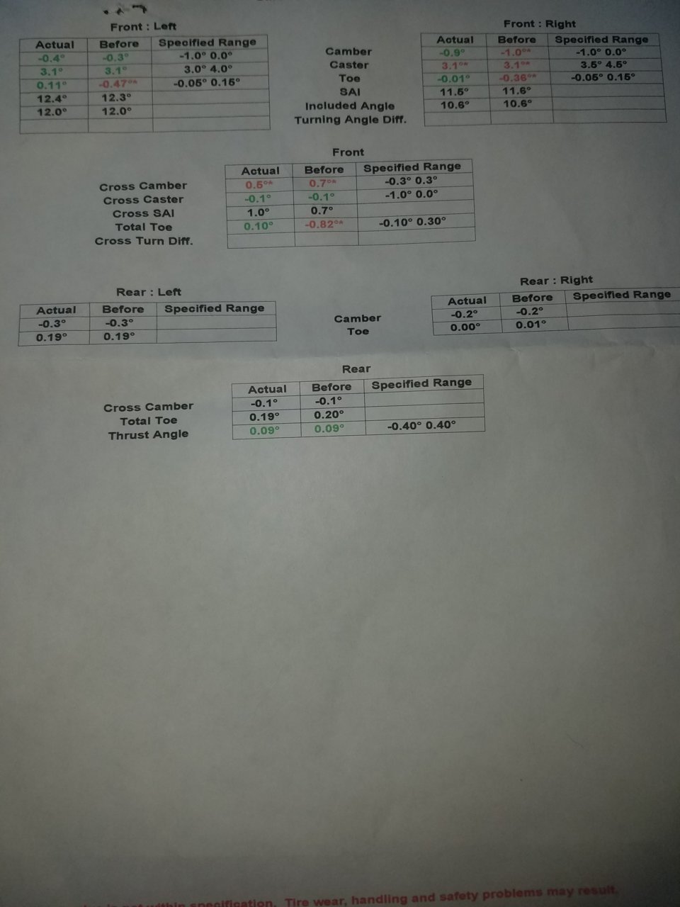

    Heres correct sheet, sorry

    Yikes. Those caster numbers are horrendous. Definitely gonna need ucas and get that alignment done correctly. And when you go, caster , camber , toe adjusted in that order. Shoot for 3.5 -4 degrees of caster. I run 4* caster , 0 camber .05 toe personally.
