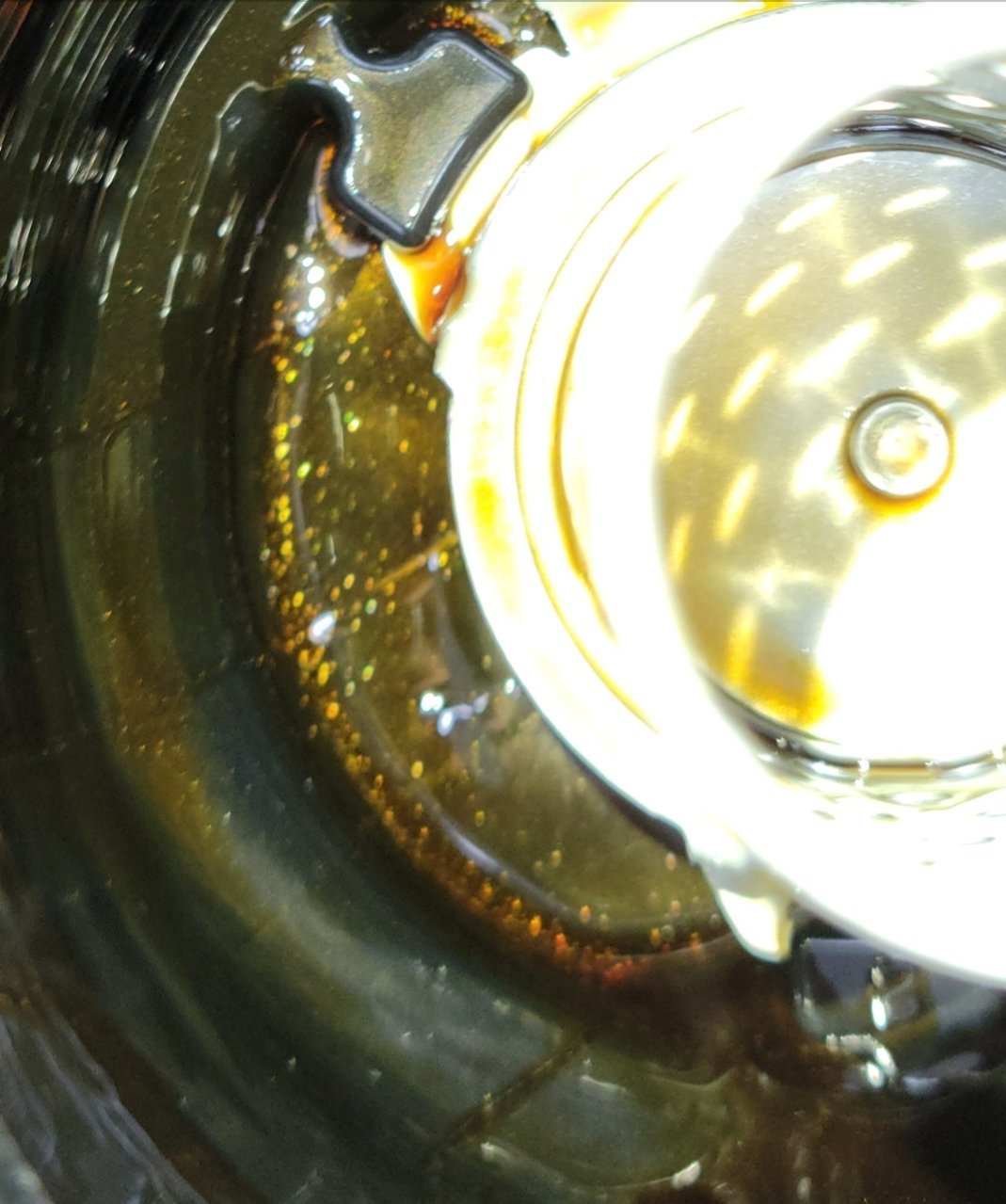

    No metal in your filter even on the 1st change? I had some, but I expected it as part of break-in. If there's a bunch in the next time I change it I'll be a little bit more concerned

    I agree, it was odd for no metal in the filter, was your metal steel or aluminum?
    I was annoyed by the ticking, I agree it sounds slower than normal injector cleaning cycles, that’s why I pulled the filter early. It does sound predominantly on the left bank.
    I am a mechanic by trade and most my friends are too and they all look at the engine thinking it’s not healthy. But from experience, without metal in the filter, it’s not a mechanical failure. That leads us to believe it’s a programming “feature”.

    I'm not sure what type of metal it was. I didnt have a magnet on me at the time. Like I said, not too concerned as I figured there'd be some flake an bits in there from break in. I'm thinking about sending out a sample for analysis before my next oil change for shits n gigs. And yea I hear ya. I work on rather large marine diesel engines for a living (I'm talking ones that have their own head, fuel pump and multiple injectors for each cylinder). I'm used to monitoring cylinder temps, firing pressures, fuel pressures, fuel rack position, bearing temps, crankcase pressure, load % and all sorts of fun stuff (If only toyota gave us that kind of monitoring capability :rofl:). With what I'm used to, usually any problems will first present themselves as abnormal temps or pressures followed by abnormal noises. A lot of times the oil will look mint and even come back A OK on analysis until shit really hits the fan. That being said, if your tacos doing it, my taco is doing it, and everyone who responded to this posts taco is doing it...makes me feel a little better about it. Anyways, thanks for the response
