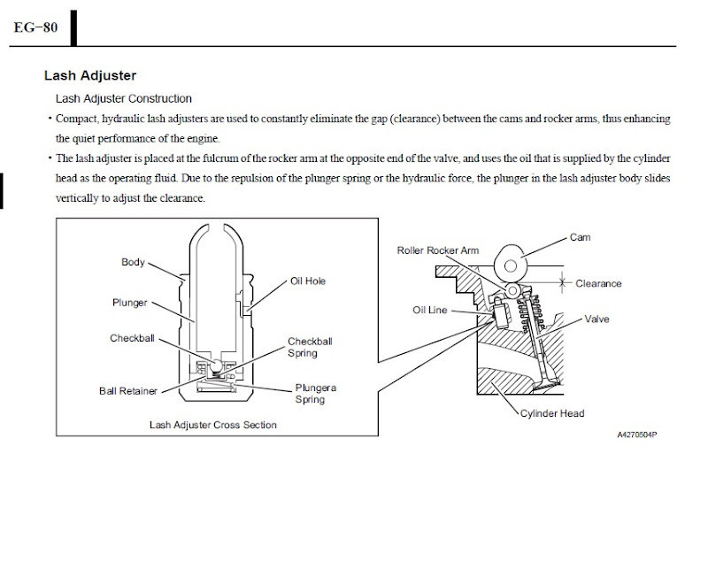

    y'all know these engines don't have lifters, right?

    An OVERHEAD camshaft actuates the valves lol.
    Please point out the lifter to me in the pictures below:

    Exactly, they have lash adjusters and roller rockers, Not really lifters.

    That's a hydraulic lifter lol.

    Some engine makers call lash adjusters “tappets”.
    If they’re hydraulic they all take up lash in the valve train. It’s just that a lifter is typically in the block and is actually transferring the lift to the valves, not just controlling lash.
    There are also “bucket” tappets or lash adjusters where the cam directly operates the valve thru the bucket. No rocker arms.
    Six or a half dozen, we all get the idea when someone calls it a lifter.
    Lash adjusters, lifters, buckets all can be non-hydraulic as well. Typically they are all adjustable via a set screw or shim.

    The "lash adjuster" is a hydraulic lifter.

    Weird that they(Toyota) call it a lash adjuster instead of a lifter like you think it's called. What do you think actuates the valve because it sure isn't that component?

    It's the rocker in conjunction with the lifter....
    I know you are a google mechanic, but most people in the field would call that a lifter..
