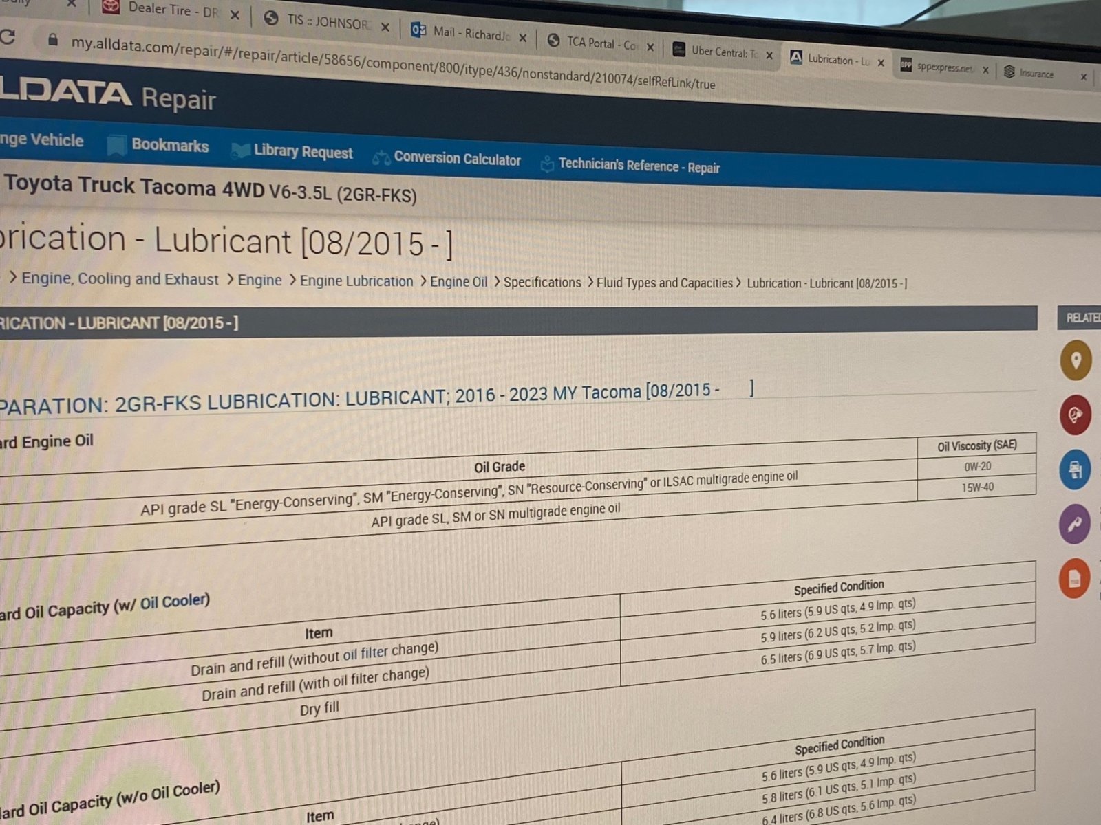

    From the Dealer you get a wide range of viscosity you can use.

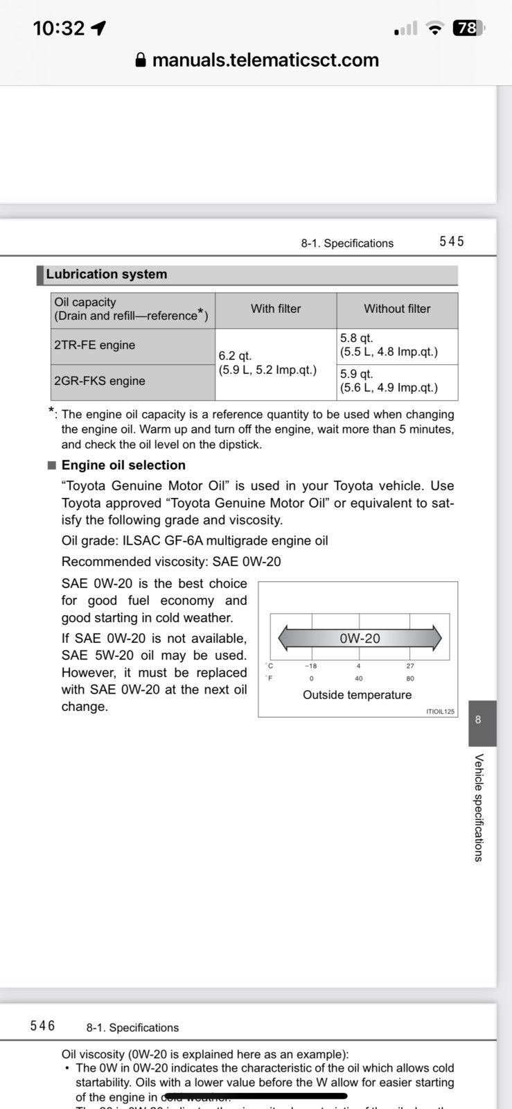

    In my 2023 manual Toyota says you can use a higher viscosity oil 5W 20 but you must replace with OW 20 next oil change.
    “If SAE OW-20 is not available, SAE 5W-20 oil may be used. However, it must be replaced

    Of course, that's the US owner's manual. Mexico owner's manual and the factory service manual say up to 40 weight is okay, provided you don't use 10W-30 or 15W-40 below specified minimum temps.
