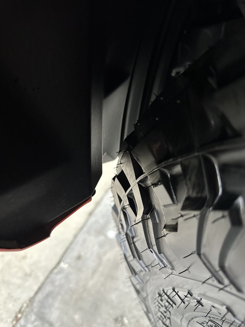

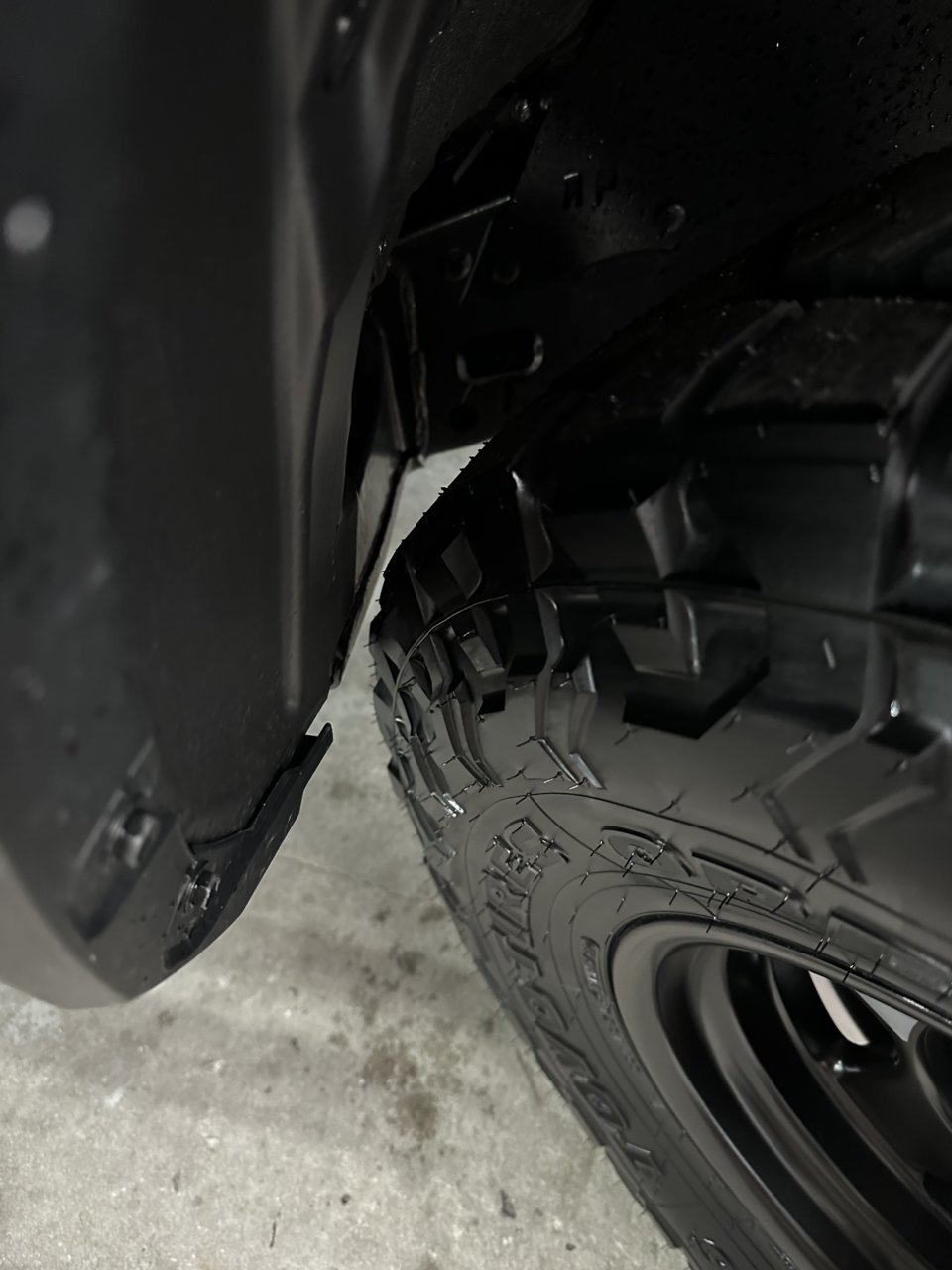

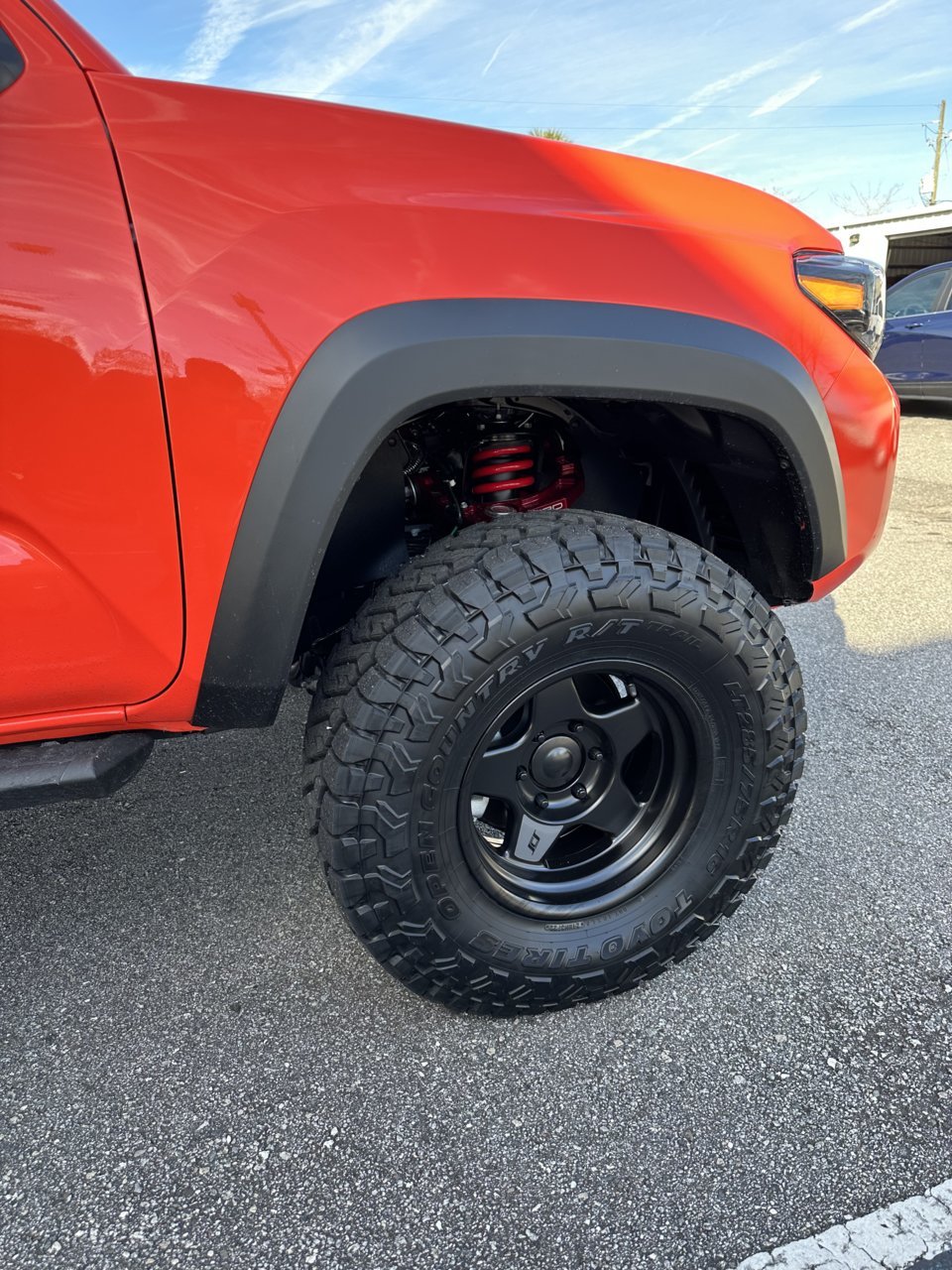

    I have a 2023 TRD Pro with the Westcott Designs kit and 285/75r16's. Love the setup and did not need a CMC. BUT! if you plan on running the stock wheels, you will need wheel spacers because 33's will rub on the new red UCAs. I confirmed with Westcott. I have -25 offset wheels. and anything between 0 and -25 will clear them. hope this helps

    Have you wheeled it yet? That's tight in the cab mount area....

    Have not wheeled it yet. it's definitely tight but clears around town. -25 is pretty aggressive and im sure a lower offset wheel would have much more room. CMR and viper cut are in the future tho... I know 33's are just gonna end up being a gateway drug to 35's
