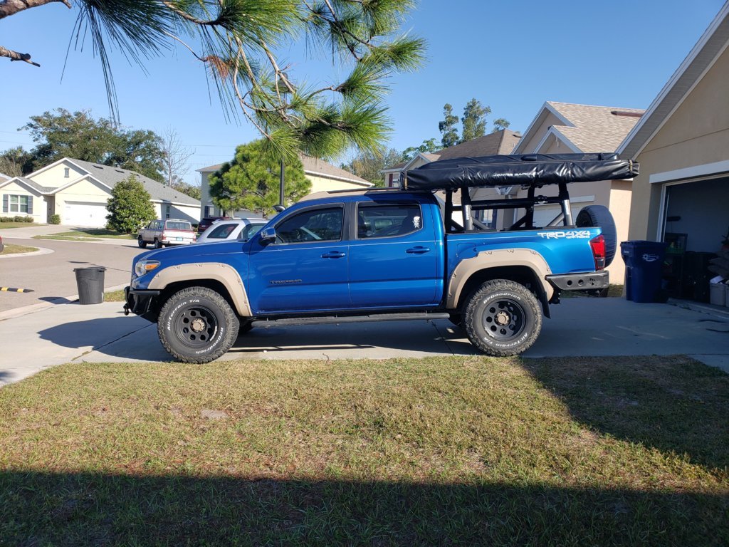

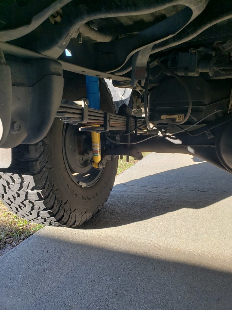

  11. Feb 10, 2025 at 6:32 AM
    StewJ
    StewJ Active Member
    May 20, 2020
    #328729
    37
    2018 Blue Pearl Tacoma TRD OffRoad
    -Aftermarket step rail -Like-stock roof rack -Gator tri-fold tonneau bed cover -1.5 inch wheel adapters -Aggressive aftermarket fender flares -Katana low beam LED headlights -Techmax high beam and fog LED headlights -Matte black plasti-dipped stock wheels -Replaced stock interior lights with LEDs
    A new leaf pack designed to handle more weight is the best solution, but I use an Icon 3-leaf AAL in the back, and I kept the overload springs. I have a high clearance rear bumper and a Yakima bed rack and a large rooftop tent sitting on it that equates to about 400-500 pounds and my truck sits at stock ride height in the back. I haven't overloading the bed, but for 400-500 pounds the Icon AAL work perfectly and don't break the bank for me.
    The front is a little lower due to the driveway angle, but I have about 4 inches of up travel and 4 inches of down travel in the front, so it works as intended.
