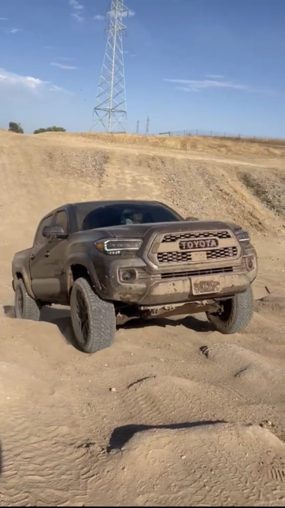

    Trd kit does work for a 2wd I just don’t know why Toyota wont install it. I’m running the unbranded trd kit, which is billstein 5100 2” and 1 inch rear blocks on my 2wd. You can buy the trd kit and install yourself or take it to a shop. Many others go even higher with no issues, you can lift a 2wd wit more options because there aren’t cv axles to worry about. Notice when you see the street trucks that have giant lifts they are often 2wd because you have so much more room to work with.
    Don’t listen to the haters about lifting you 2wd. Make the most out of it. I off road my 2wd all the time it goes 90% of places 4x4 guys go, you just gotta do some sort of rear diff posi/locker mod, air down a lot, and make smart line choices. (mud and snow are your limitations) and I have a blast with it every time! Lift away!
