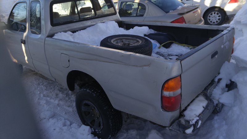

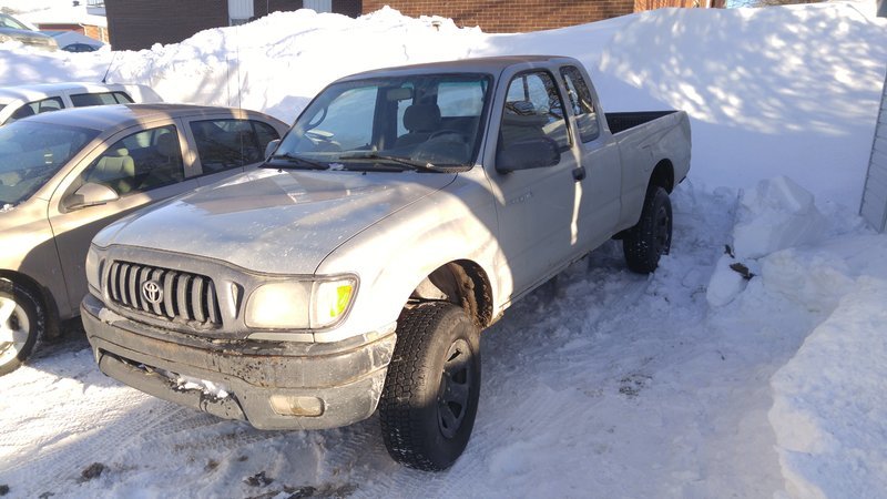

    Hey,
    I am thinking about lifting my first gen and I have to discuss with some people that did it. I want to lift it because I need the ground clearance since I work in forestry ( 40% and 60% gravel road, old trail and creek crossing) and I also liked the look of my lifted 1st gen that I just sold (it had a 2" or 3" front coil spacer and same for the block and stock shock).
    What type of combination should I use? Is it a good idea to stay with my stock shock?
    I do not have a big budget, maybe 500$ max. canadian dollars. lol.
    Thanks !
    Here's some picture of the stock truck.
