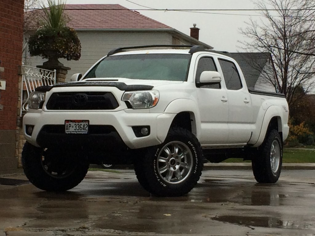

    This is BILSTEIN 5100 set at 2.5” in the front, 5100 in the rear with an add a leaf. Tires are 275-70-18.

    Wow looks great and thank you for the response. Did you have any issues installing it at all? Also what is the offset on those rims?

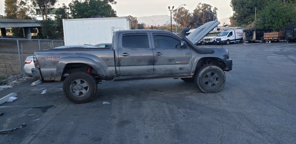

    Broke my toytec coilover, and rear strut. Had to go rough country 3.5", have diff drop, and carrier bearing spacer.

  16. Jan 4, 2025 at 7:28 PM
    #16
    Kenjisan08
    Kenjisan08 Well-Known Member
    Aug 7, 2018
    #262057
    139
    looks nice! any head on shots to show how they sit in wheel well?
