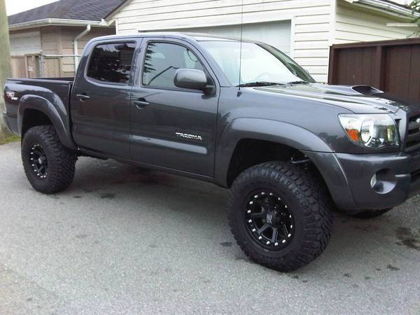

    I'm running the 285/70/17's with about 2.25" of lift in the front. These are the perfect sized tires for this truck, in my opinion. Other then a bit of trimming to avoid rubbing, they are nearly a perfect fit. I would buy the 285/70/17's and don't look back!

    Please post a picture of your truck!
