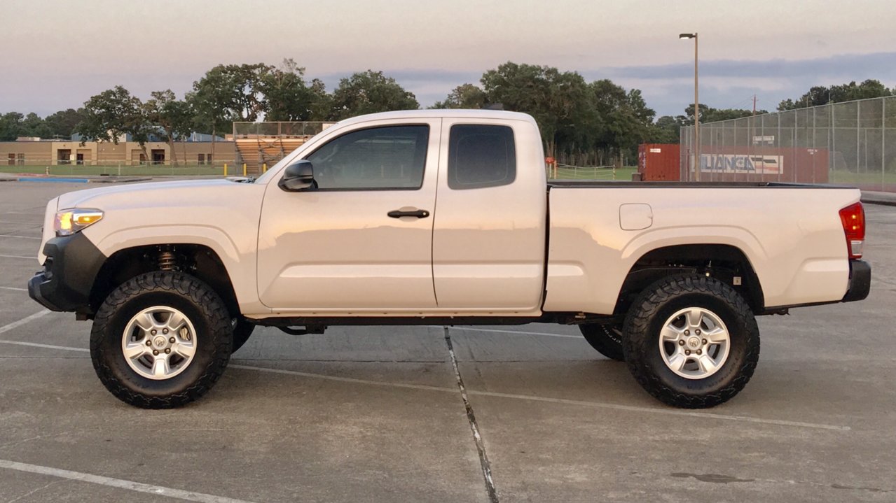

    I recently picked up an '18 Tacoma SR
    I have 17" TRD wheels with 265/70/17 Falken Wildpeaks to be installed this week. I want to lift the truck a little for aesthetics, ride and performance. Looking for roughly 2-2.5" with a level ride height. Can you folks help me decide on a decent lift that wont break the bank? I'm thinking a 5100 / OME Spring / AAL combo would suit the truck and my budget but I just cant decide on the specific 5100 settings and spring / AAL combo.
    I know the SR sits a bit lower than the TRD's from the factory but I really like the look of this truck and would like to achieve a similar stance. This truck belongs elduder and is running 887/5100 and 1.5" AAL on a TRD Sport. I assume i'd achieve the same look with the same components, correct? Anyone else running a similar setup on an SR or SR5 that could post pics? Also, any thoughts or advice? Thanks in advance for the help.

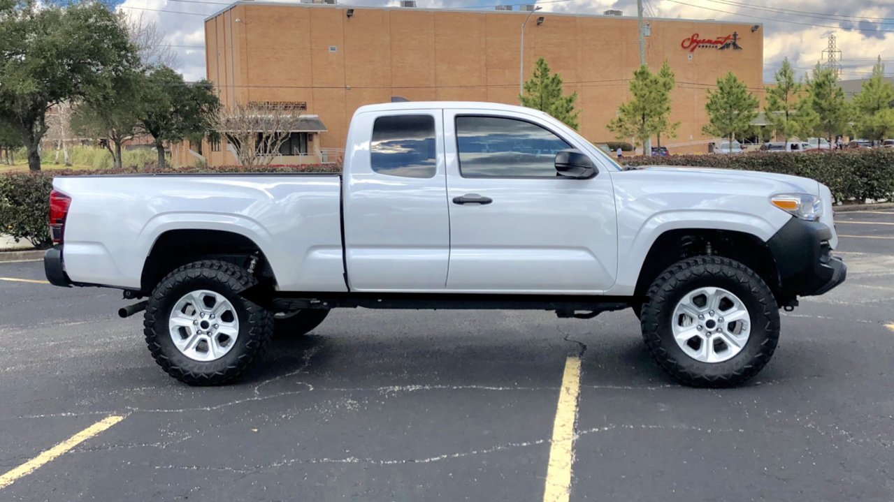

    Thanks for the info and advice everyone. I Ended up going with 5100s all around. OME 887 coils and a Wheelers 1.5” AAL
    Original ground to fender measurements
    DF - 35 3/4
    PF - 36
    DR - 36 3/4
    PR - 36 3/4
    After
    DF - 38
    PF - 38 1/4
    DR - 39
    PR - 39
    I’m sure there will be some settling. I’ll retake measurements in a couple weeks to confirm
    Probably should have thrown a lean spacer in but I didn’t acquire one and I felt like getting the suspension on while we had a couple lower humidity days that were comfortable enough to work in. I am also now wishing I would have just put 285’s on when I got the TRD wheels but I am happy with the look for now. I will say that the ride is noticeably improved over the stock SR suspension. I like the higher seat position too.
    I do have a squeak that I’ve noticed from the rear suspension when going over bumps in the road. Any common offenders that others have experienced with 5100’s and / or an AAL? Seems to come from both sides sometimes and the drivers side all the time.
