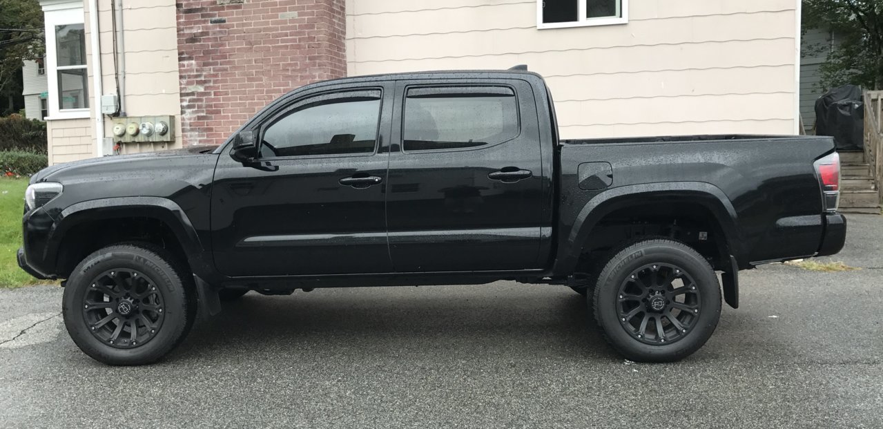

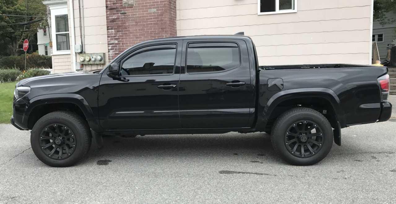

    This is that exact OME kit, before and after:
    3174DBD8-4B80-487F-90A9-468CE60E813D.jpg 4E001743-BAEA-4138-B5D2-D82CE1F8315C.jpg

    Perfect thank you.
    Just what I am looking for. I like the Rake of the truck the way it is.
    My mistake for saying it will level it out. That was a misunderstanding on my part.

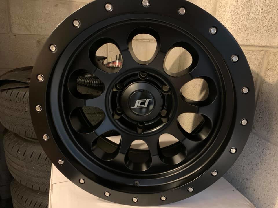

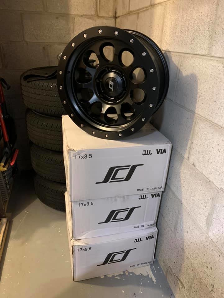

    Yeah....On the fence on 285's due to the fact that I don't want the trans to be gear hunting. That said, I just ordered a set of SCS RAY 10's in Matte Black. I'm thinking the 285's are a go. I know they'll likely rub a little and i'm fine to trim out some plastic but I don't want to have to do a cab mount chop. We shall see.

    I'll be installing these in October. I'm going with the 285/70/17 Falken Wildpeak AT3W's
    Thinking I might throw on new UCA's as well. Anyone have a recommendation? I was thinking I'd go with the Dobinsons UCA's because I've been pretty happy with the leaf pack I have from them. With that said, I'm open to other suggestions.

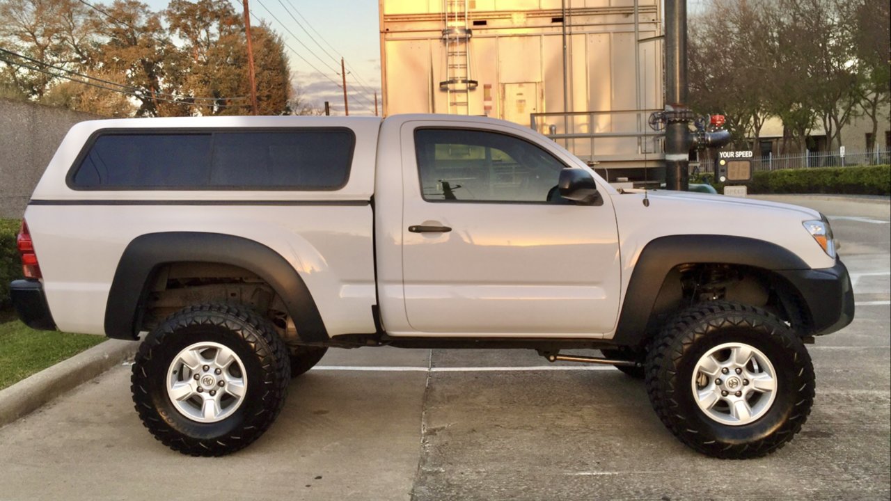

    I like the look of the second picture in your post but can't place those Toyota wheels. I know the top ones come off a 4 Runner I believe. Also, what is the lift and tire information with the second pictures. Looking though your posts and all your trucks you seem to have a knack for putting together excellent combinations(wheel tire lift) Very nice!
  16. Aug 24, 2021 at 9:54 AM
    #36
    5465
    5465 Well-Known Member
    Mar 4, 2017
    #212289
    939
    South
    2023 TRD Ex Cab
    Older Sequoia or Tundra 6 lug wheels, they have a little more offset which pushes the wheels out a little further. (I don’t recall if I ran spidertrax 1.25” wheel spacers with that setup, maybe not ?)
    Tire size was 285/75/16, lift was Toytec coils over lift with 1” rear block, set to max lift without binding inner CV boots.
    Sequoia/Tundra part # 42611AF110, found both sets on Craigslist.
    Those are one of my favorite wheels sets, this is a completely different setup. I miss all of my old vehicles : )
