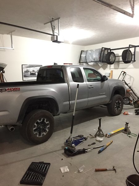

    Just starting a build on my 2017 TRDOR. Went with Headstrong 5100s 887 and AAL. The truck went up 2.25 in the back and 2.75 in the front. It seems the front tires have a lot more Camber. Will fit tires later this week. BFG KO2's at 275/70R17. Then can get an alignment.
    Front end was too tall with 887. Should have done a shorter spring. Tough to get the alignment right but even then would have had trouble with the tires scrubbing when articulating through the normal arc going down the road. So we put the 5100's on the first notch up with the original front springs. Ended up with about 1.5 inches of lift in the front.
    Then got the KO2's in 275/70R17 and American Racing Baja Black rims. The original lugs didn't do more than 5 turns, so Tread Depot sent out some ET lugs and they worked great.

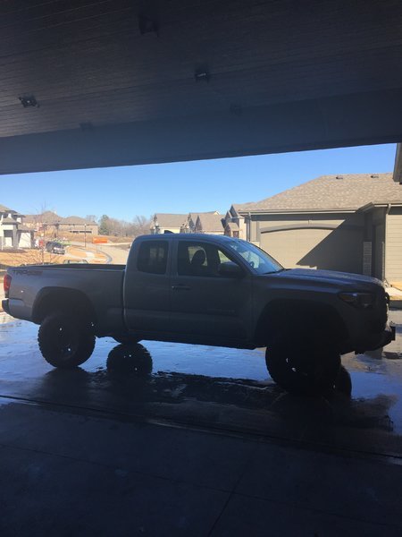

  16. Jan 18, 2017 at 11:44 AM
    #16
    tfree
    tfree [OP] Well-Known Member
    Sep 25, 2016
    #198174
    82
    Nebraska
    2017 TRD ORAC
    lighting is terrible right now. Sorry about the images.
    So I went from 35" in the front and 37.5" in the back to 38.75 in the rear and 37.25 in the front. This is how I got there:
    1. Tried the 887 springs and AAL with and gen 5100s all around and was too high (about 40" front and rear).
    2. Went back to stock spring in the front and left the AAL in. Increased front shock to one notch above stock height.
    3. Added 275/70 17 BFG TKO2s.
    4. Added armor.
    Ride is now perfect. Height is pretty good. If it sat a touch lower it would be okay. Topper and roof rack should level it out nicely.

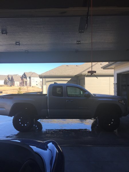

  17. Jan 18, 2017 at 11:48 AM
    #17
    tfree
    Sep 25, 2016
    #198174
    82
    Nebraska
    2017 TRD ORAC

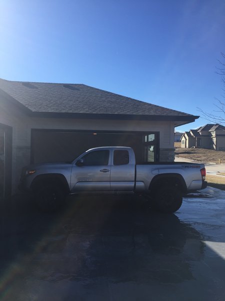

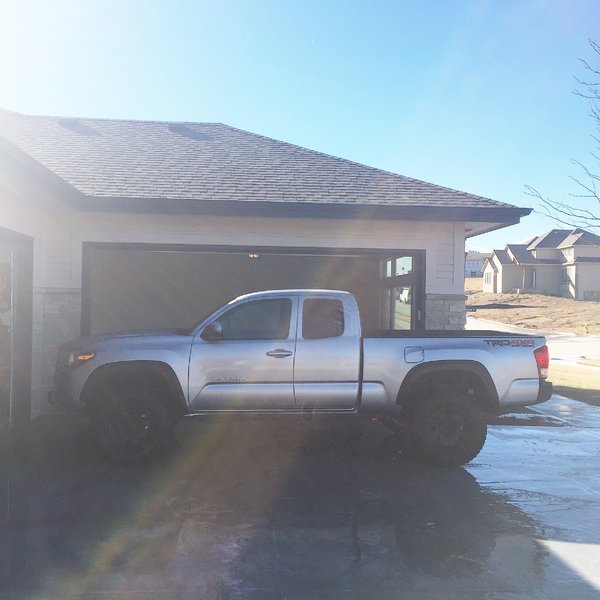

  18. Jan 18, 2017 at 11:58 AM
    #18
    tfree
    Sep 25, 2016
    #198174
    82
    Nebraska
    2017 TRD ORAC
    You can see a little better with that editing.
    Answers to questions:
    Brokinarrow, I did not use the 887's. Maybe in the future? If someone wants them cheap I'll part with them.
    dYL0n, no problem with CV angles. I'm up a total of 2.25" in the front, but at least an inch of that is sidewall on the tire. If I was running stock tires it wouldn't be nearly as noticeable. Nothing rubs or is stressed.
    Diablo169 1.5" with 885 sounds about right, and I might go back to that spring so my shock could be at the lowest setting. I want to wait until the rest of the heavy stuff is added.
    Blktre, it's not you, I sometimes assume every has information I haven't given as I skip steps in my explanations. Side shot is for you. Will get better one if you want when it's not parked there. Hard to believe I teach as part of my job. :)
