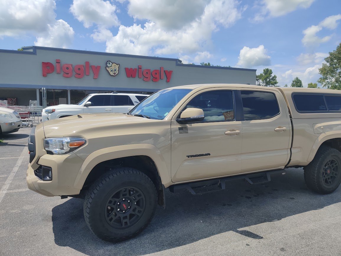

    A basic 2" lift using Bilstein 5100/OME 887 front, set on 1 (the springs do the lifting), and Bilstein 5100 and a Deaver add-a-leaf in the back.
    Tires are 265/70/17, which gives the best compromise of larger tire and descent mpg(IMHO).
    So in total, this combination gives the truck a 3" effective lift.
    My reason for keeping it at this height was to minimize the "side effect" work that would need to be done. I did install the ECGS bushing because i got the vibration, but i didn't need to cut or bend anything for the tires, or change the UCA, or add shims or modify other stuff due to drive shaft angles, etc.
    I also put the pro grill on to lower the TSS back to close to the stock height.

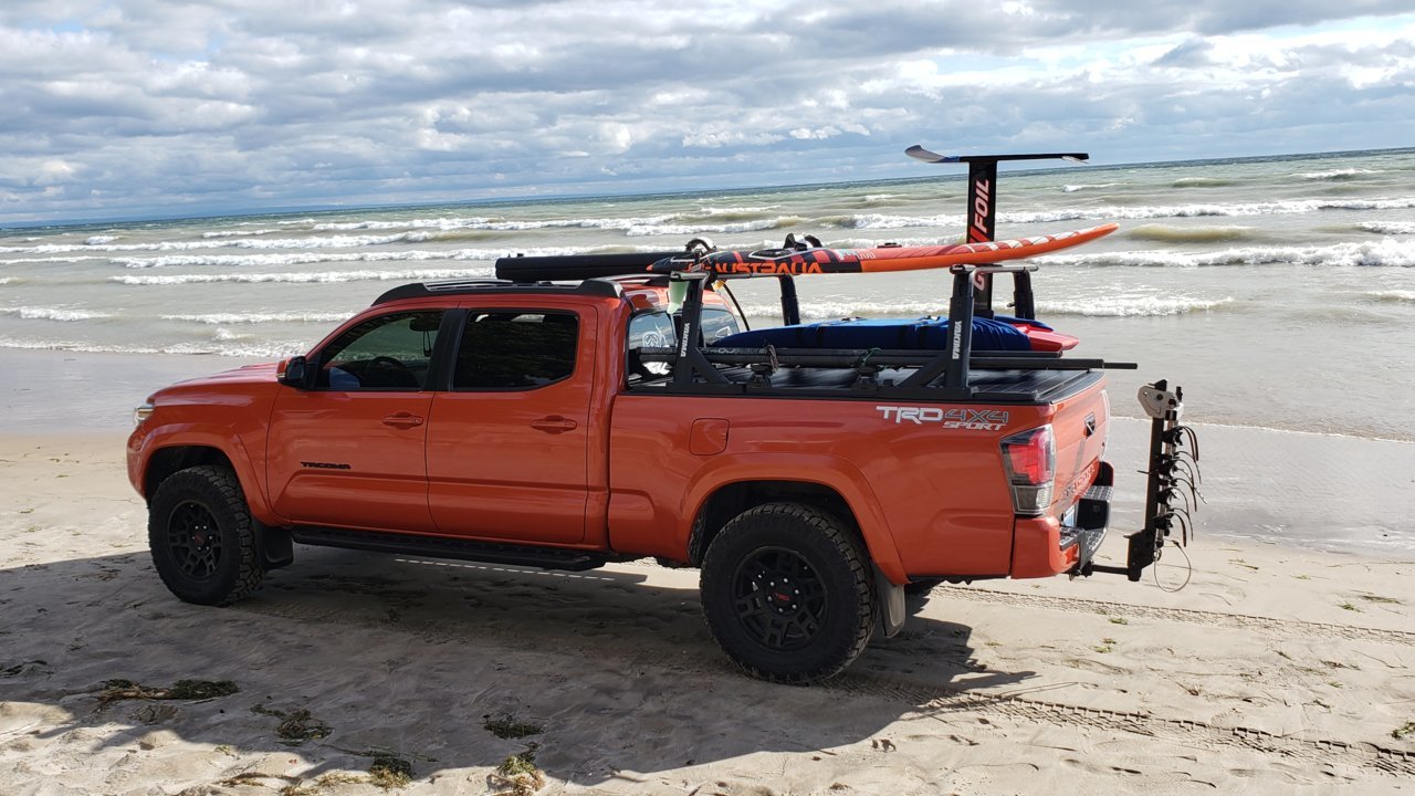

    I have a 21 Dclb with what essentially is the TRD lift kit, except I went directly with Bilstein 5100’s for a 2/1 lift level.
    Zero issues with TSS , or anything for that matter. Ive had it for 13 mos now and still no problems at all. Added Heritage grille as well with aftermarket garnish and everything is smooth sailing. I don’t know why that kit isn’t listed for DCLB, but 5100’s are . They are the same shock.

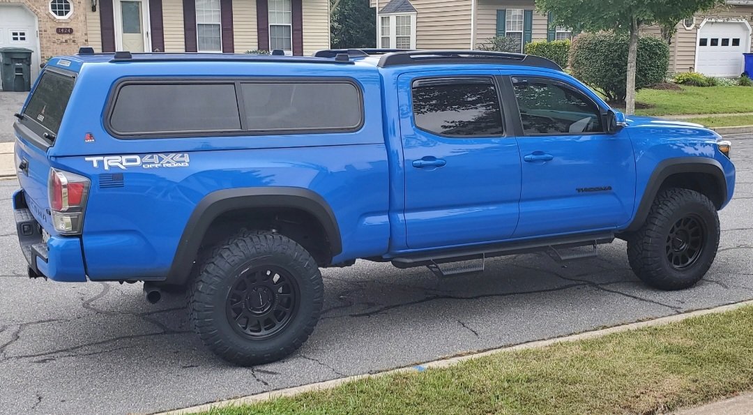

    I went with RC struts with the upgraded shocks, 3" front, 2" rear and 285/70-17....no rubbing and no cutting. Zero offset and sets the edge of the tire just outside the fender. Screenshot_20221004-201007_Gallery.jpg
