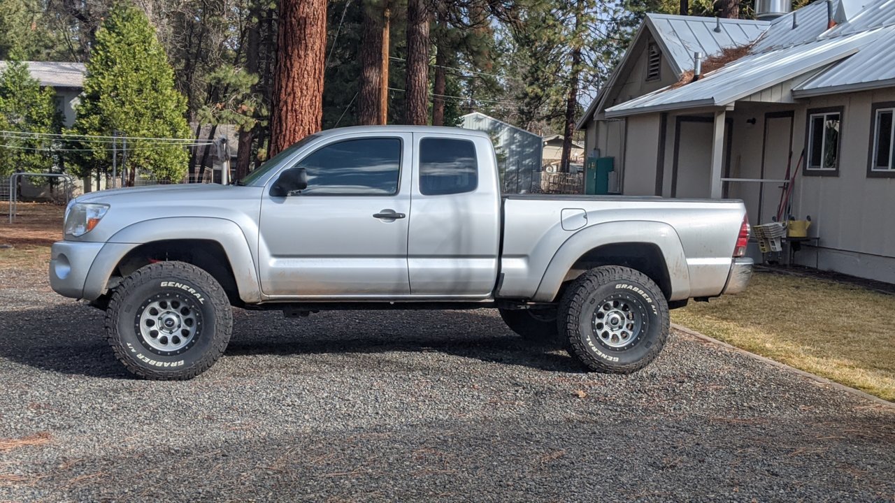

    Here's mine with a 2.5 inch lift and 33x12.2" tires (305/70R16s):IMG_20200105_115341~2.jpg

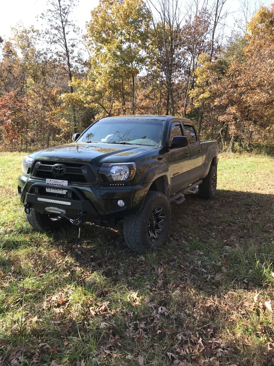

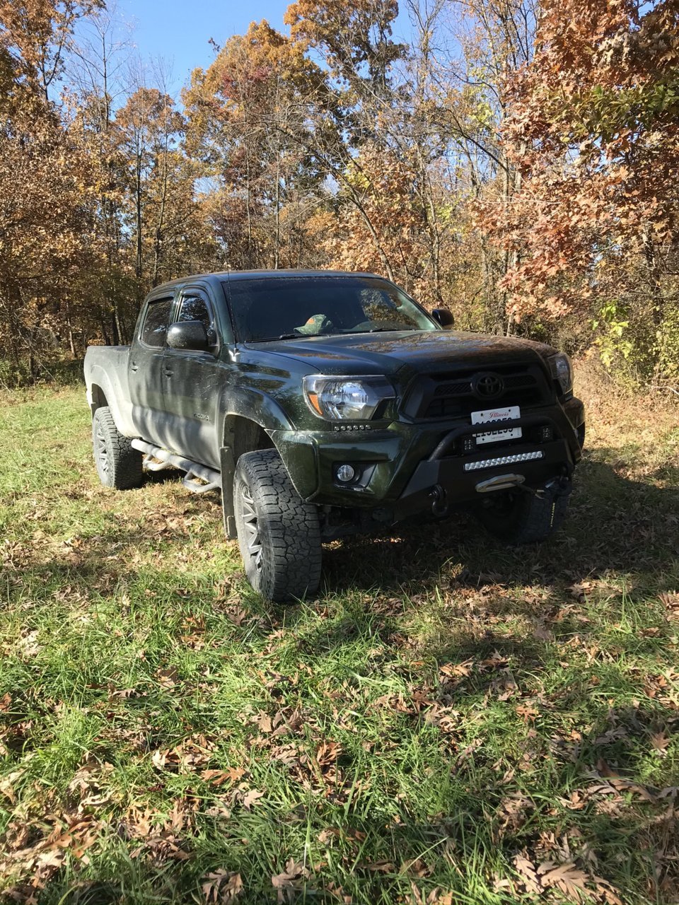

    I’ve had a 4 inch drop bracket lift on my truck for 2 1/2 years with no problems or issues. As long as you don’t mind cutting your cross member and everything’s installed right you shouldn’t have any issues. Like you, I like the stance.
    doorsidedown and Ccrames2018 like this.
  19. Mar 29, 2020 at 9:50 PM
    #19
    Ccrames2018
    Ccrames2018 Jack of some trades.
    Mar 7, 2018
    #246573
    1,475
    Caden
    Nor Cal
    07 AC 4x4 V6 6MT
    -Bilstein 5100s @1.75" -16x8 SCS Ray10s with 305/70R16 General Grabber AT -CMC -URD Short Throw Shifter -Bed stiffeners -Bed mat -Aftermarket head unit -AFE Rebel exhaust -ME-SO Customs dome/map lights -Window tint with eyebrow -OEM LED 2015 tail lights -GTR Lighting headlight bulbs -Husky floor liners -Camper shell -Sumo Springs -Air intake -Aftermarket Volkswagen key fob -Aftermarket A/C knobs -Aftermarket LED license plate lights -Console organizer -JBA High Caster UCAs
    Yep, people hate on drop brackets but I kind of wish I had gone with the 4 inch BDS instead, with 35s. The 33s and 2.5 inch lift do look great though
  20. Mar 29, 2020 at 9:56 PM
    #20
    buckhuntin-tacoma
    buckhuntin-tacoma Shed hunter
    Dec 10, 2017
    #238191
    14,608
    Dennis
    Quincy IL
    2014 Spruce Mica Tacoma DCLB
    Yeah, lot’s of haters. I’m not a hard core wheeler but I do a lot of hunting so plenty of off- roading. 72A8292E-6CF3-4C17-BFAF-C2C80CA95836.jpg10D67FE4-CA2C-4243-ACA9-0E53C057794B.jpg
