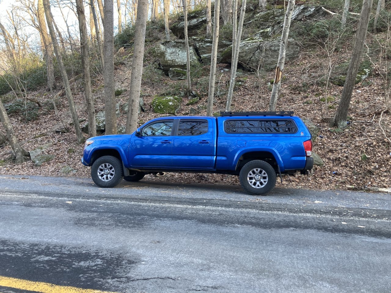

    Hey Y'all,
    I've been reading the forums here for a while and finally decided to make an account with the hopes of getting some advice for lifting my truck. So here's the deal...
    I have a 2020 TRD Off-Road DCLB with ~37k miles on it and its about time for some new tires so I want to go ahead and lift or level it too. I have a leer 100XR topper with rack on top that adds some significant weight to the back especially when its loaded down with tools or my camping platform setup.
    I'm looking for something that will lift the back no more than 2 inches and prevent the sag that happens when I'm fully loaded. Also either a small level or 1-1.5 inch lift in the front to give the truck a slightly more aggressive look. I might also upgrade to a 285 tire size depending on what will fit with the different lift options.
    From what I've read so far it sounds like an add-a-leaf or new leaf pack would be best for the back, and possibly an adjustable level setup for the front. Let me know what you would do in this situation. TIA.
    Photo attached is how she sits today with bed empty.

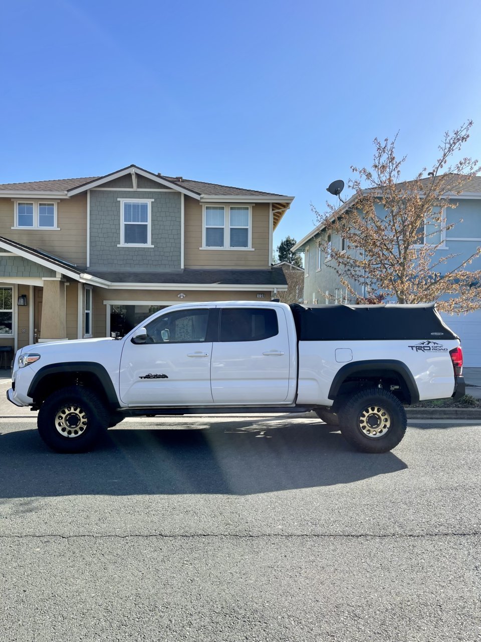

    Zach
    2017 Blue SR5 DCLB 4x4
    Bilstein 5100's OME 885 springs for 1.5" lift in the front 3 leaf AAL for 1.75" lift in the rear
    I have an almost identical set up, topper and all. What I did was a 3 leaf AAL in the rear, 5100’s all around with the Old Man Emu 885 coil springs in the front. I gained about 1 1/2” of lift in the front and just about 1 3/4” in the rear (I left the overload leaf in since I tow frequently). I still have close to factory rake but the truck is sitting pretty.
    *edited to add photo*
