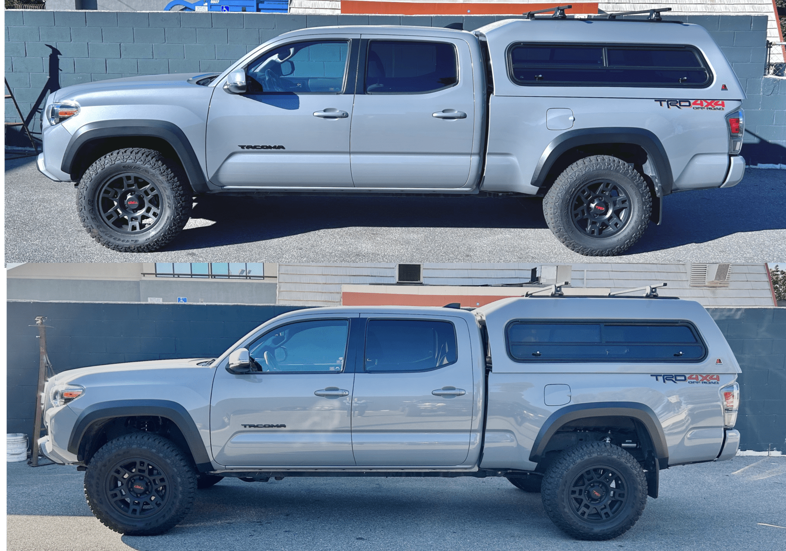

    UPDATE: I got talked into spending way more money LOL. I think I made the right choice. Ended up getting Bilstein 6112 in front (600# coils, clip setting 7+9) and 5160s in the back with the Icon RXT option 2. Had the install done yesterday and getting alignment done tomorrow. So far rides great. Expect the rear to settle out a little. I did not want a ton of lift. This ended up being maybe a little more than I expected but I'm happy with it. Haven't had a chance to measure yet. I have a fair amount of rake - did not want to be front high when fully loaded w gear.
    Before and after:

    Height looks good. Your shell looks like it is mounted 1/4" farther back on the bed than my Leer of similar shape. Is your rear door seal lining up with the tailgate edge, just curious. I'm always watching cap alignment by habit.
  8. Dec 7, 2023 at 2:49 PM
    #28
    Faroutspacenut
    Faroutspacenut Well-Known Member
    May 8, 2020
    #327311
    74
    Southern California
    2020 DCLB TRD OR
    Good catch! Yes right after this picture was taken I went back to the truck cap installer and had it re-set. the bolts were getting loose and it started to slide. Would have done it myself but had one other thing I needed them to fix with one of the windoor struts. I have lock washers on it now and will be keeping a closer eye on it!
