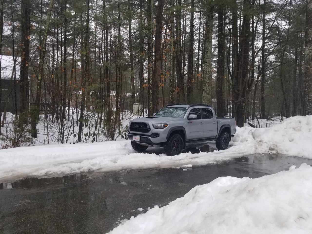

    Heres a pic of my truck now as it sits.
