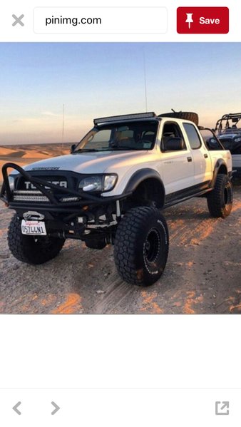

    That looks like it's from my IG! That truck was built for the mud! You've got to spend way more than $3K if you want to make your truck like that. IMO you really cut way more than need be so I'd think about running a bigger tire to match your trim job. BTW that's not my double cab. 20160416_165428-1.jpg
    I'm running 34's on a 3" lift and the only rub I get is on the chassis at full turn, but I rarely need to put it there. I'd re-gear and run 38's in that bad boy if you're gonna stay trimmed and put a 6".

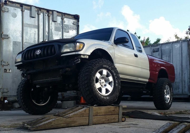

    Vrod, is there any way you could find out what his total lift is on that truck? I would love to know.
    Snowboard...to be like a jeep. I like the jeeps ability to remove their doors when I want to. But I need a truck with a bed to haul in. And I do like a challenge.
    Kiteguam... for me it is not about just clearing bigger tires. It is about the overall look. I like the look of a lot of space between the top of the tire in the bottom of the wheel well. I would like to go a total of 9 inches of lift on this. But I will not be able to do that. So trimming the fenders up at least gives the appearance of a little more space. Somebody called it the "hawaiian" look. I don't know about that but if that's what it is then OK.

    Gotcha as far as overall lift on that truck I think it's somewhat close to 9" so you could be on the right track to the look you want

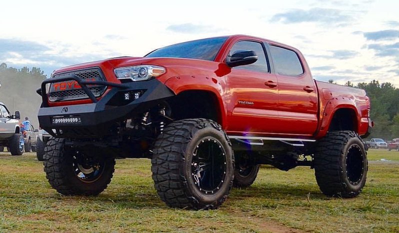

    The 1st gen pictured is SAS and the 2nd gen is a DBL

    Your going to want a drop bracket lift for your purpose of just wanting the look. The red truck has a solid front axle swapped in, among a ton of other work =$$$$$$$. Drop bracket lifts is pretty much a lift for height and looks only.
