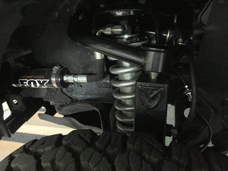

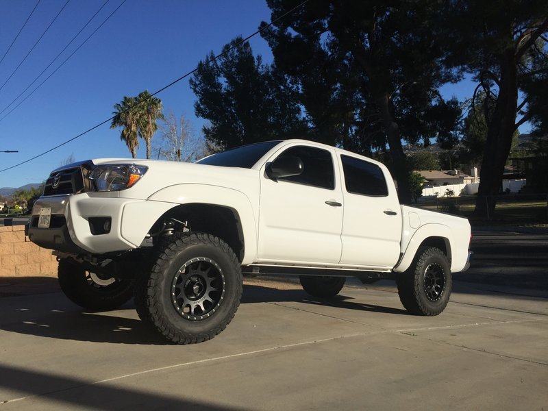

    Look into the MaxTrac spindles. Go to www.maxtracsuspension.com. Great kits and does not change stock geometry or ride. All depends on what you are doing with your truck. Spindles only work on 2WD 6lug tacomas.
    My 2015 had the spindles with extended brake lines, fox 2.5 foil overs with all preload taken out, and icon upper control arms. Method 17" wheels and BFG KO2 285/70/17 tires. Fox 2.0 shocks in the rear but factory height. Great stance and great ride. I live in Southern California so we like some nose rake. Hope this helps
