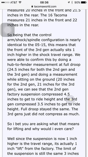

    Hello, I have a 3rd gen trd sport and I want to lift it on toytec boss coilovers and I'm a bit confused how it says 3 inch of lift but on bilsteinlifts website in the q&a section they said it'll only do 2 inches of lift. What I'm wondering is if it can be maxed at 3inches but would only be 2 inches for the 16+ since they say they're originally for a 2005-2015 model

    Gen 3 can only get about 2" of lift but it comes with a factory 1" so they consider that a TOTAL of 3".

    It has 1" of lift over a 2nd gen technically. But 0" of lift compared to other 3rd gens

    Aussiek you brought up the pro model. I stated gen 3 in reference to comparing gen2
    Here ya go.:facepalm: Straight from Toytec.

    BP 51 and Boss 2.5 will (after settling a bit) get you to a total of 2.75" MAX on a 3rd gen). I've been researching (manufacturer direct, not trolling tw for hearsay) this religiously for over three months. I went with the Icon stage 4 after they all pretty much matched up evenly performance wise on and off road and was informed of a huge discount available. if size matters to you over performance :rofl:look into full diff drop kits that will net you 4+ inches. Otherwise, bask in the news that your rig has a 1" lift!!:thumbsup:

    Geez bro. Manufacturers use this same gen 2/gen3 comparison as you can see. That's the standard measuring stick in the industry. You have a different idea of it. I provided the OP with the answer he needed. Thx
