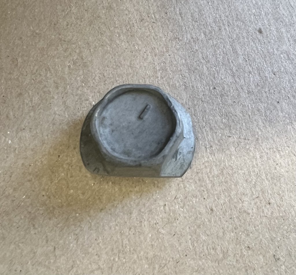

    I experienced the opposite, the driver's side was the most difficult for me, so the vehicle tolerances can change things - be prepared for anything. A couple of things I learned from my second time removing the UCAs while replacing the bushings. Leaving the passenger long bolt entering from the bottom as it is from the factory - there is just more room going down. The Driver's side bolt I found it best to feed it from the top, so I did not have to remove a brake line joint frame attachment. I also ground off the flange on the bolts up to one of the six bolt flats - this allowed for a bit more wiggle room around the sheet metal.
    On my initial UCA install I cut the bolts off. Every time I do something to the truck; I look to see how I can make subsequent work easier. Sometimes the factory puts them together not thinking of how they will be serviced.

    Oh yes, on both fenders on the initial removal. It is very common to have to bend sheet metal for this procedure - that was the first thing I noted when studying the procedure. The ground off bolt flange will help immensely upon the next UCA work, especially on the driver's side as I never did permanently bend the sheet metal to free clear the bolt. i.e. there is still some "spring" to the sheet metal.
