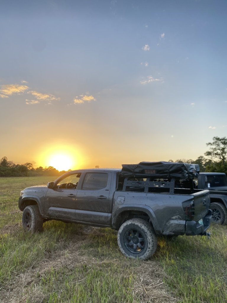

    I do exactly what you are hoping to do. Be capable offroad and still drive highway miles. If it will make you enjoy driving. Do it. That being said, its a snowball effect the second you lift. With both of those being said. Theres nothing better than driving a dialed in truck, offroad.
    I stuffed 285/65/18 (32”) on icons. Required more work than i anticipated. Had to add block so it didnt bro lean. Cmc to fit larger/wider tires. Eventual leaf kit…snowball.
    The main difference between the brands is progressive vs digressive. Other than that, any of them will be just fine for what you want to do.
    Ive also had a shop install and installed myself. If you have a couple buddies to help, its not too hard to install and you can save a few hundred bucks. Hope that helps. GL
