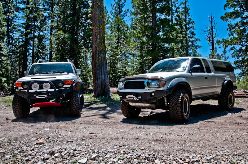

    No these the Expos this is what i have and they are nice springs. They flex good bran new so broke in they should be really nice. I can wheel with 600+lbs of camping gear and my shell on without bottoming out. All around great springs they are kinda stiff if the beds empty so be aware of that. And they will give you over 3" of lift i got just about 5" but i got shackles too and they lift me 3/4"
    That's my stance with 800+lbs in the bed
