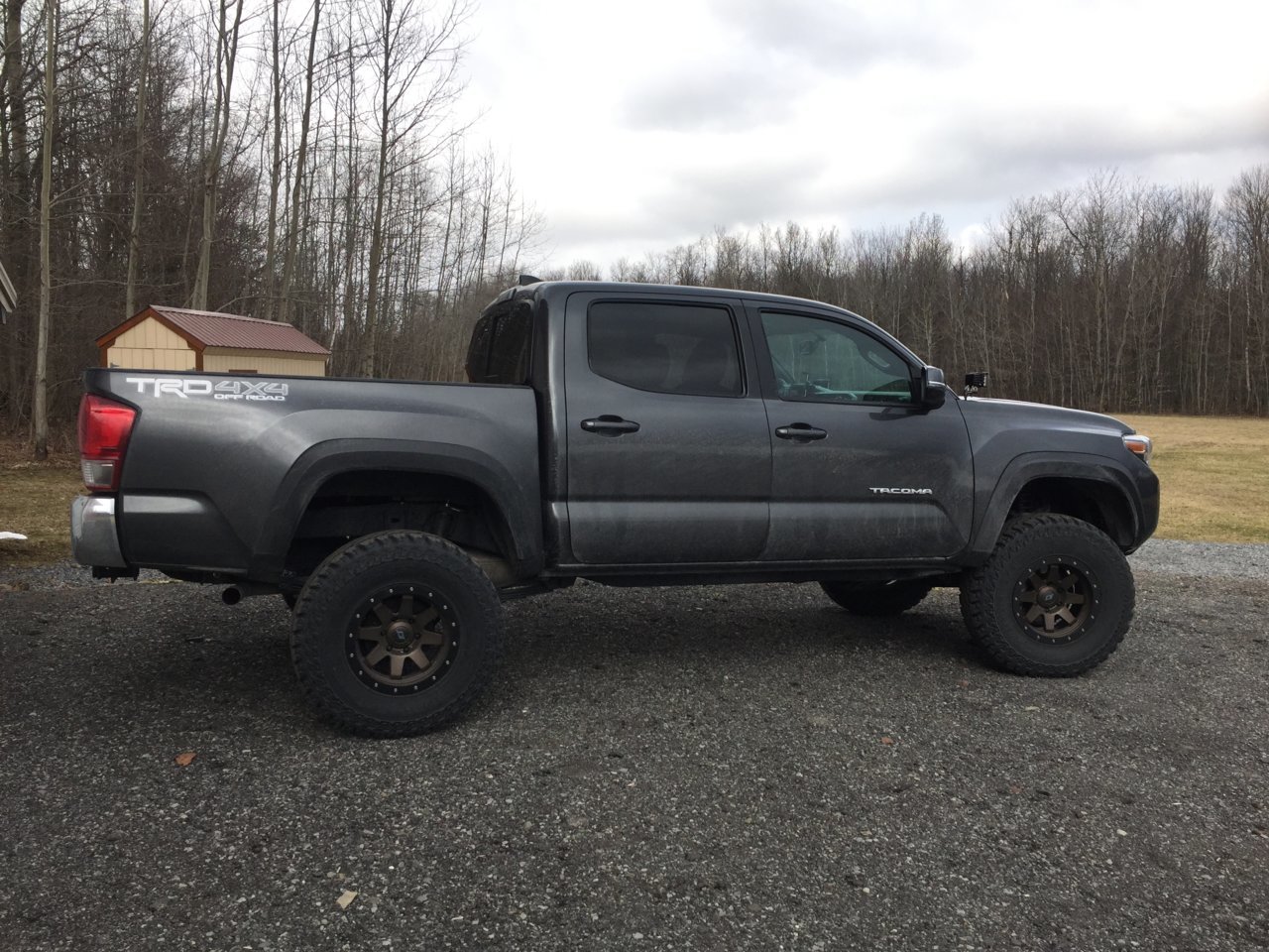

    You’re looking for shop suggestions? Where do you live? You positive you want to do 4”???? That’s not as easy as it sounds.... think a little smaller save yourself a ton of trouble, there’s literally 1000’s of threads on here for 3rd Gen lifts. I’d suggest contacting Marie @HeadStrong Off-Road and tell her what you’re thinking.
    Set a goal for tire size, budget and go from there. You can spend a small fortune doing this so be forewarned.
    3” on 255 85 R16’s (Which are 33’s)
