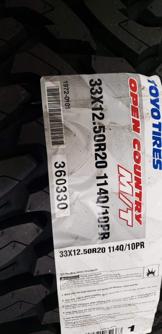

    This shocks alone will lift the truck?
    I needed 3 inchess so i can use this tire

    I think those are for serious off roaderooks like l be looking at around 6k if i go that route

    Don’t run mud tires if you don’t off road. Just go with ATs. Mud tires are loud and the pavement will eat them up quick

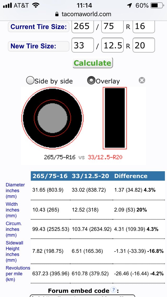

    Get some blocks and spacers. Those are some very wide tires, so a CMC and some trimming is going to have to happen. Just using those tires your going to be going down a rabbit hole with those tires alone. The red outline is the tire you want to put on

    Lol thanx i want something wide
    Perfectly even witht the black fender trim

    Those tires are really wide, its gonna take a lot of modification to fit them
