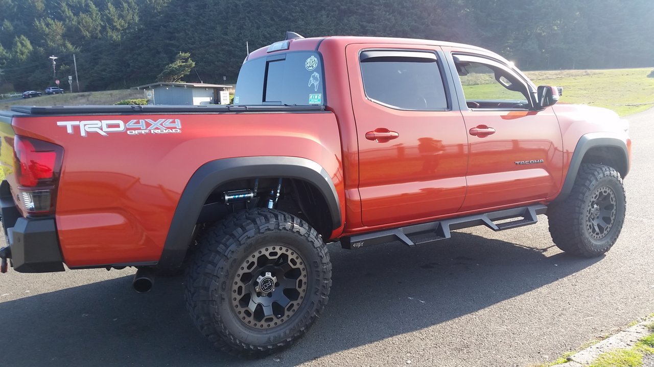

    OP you do not need a diff drop if the lift is 3" or less. If you get this kit, which I have" it actually gets you more like 2.5" when all is said and done so your easily within safe range. Call King directly and they will tell you they do not recommend a diff drop, spacers or any other add on. Anyway you will be absolutely stoked with this set up. You'll find yourself actively seeking out speedbumps and speedhumps when not offroading. Sorry kids but your 20 mph zone just became a 50mph zone :rofl:
    Incase you were curious I'm running 33x12.5 Toyo M/T on 17s with -12.5 offset. I would go with 0 offset if you want your tires closer to flush to the outside of the flares. -12.5 offset make my tires stick out past the OEM flares approximately 1.5" but I also have Bushwacker Pockets waiting to be picked up at the Rhino Liners so not an issue. And you may not need a cab mount chop either with 0 offset but I'm not certain about that.

    Damn thats a sweet looking truck
    I want to make my truck look like this
