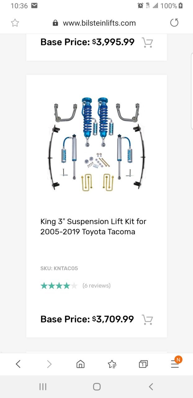

    With this kings lift set
    Will i be able to use 33s then without any problems?
    Or what size tires should i get then?
    Im about to order this thing

    285/75/16. You will most likely have to CMC cause you will rub a little on the body mount.

    It’s not a big deal about cutting the cab mount(cmc) everyone that goes wider tires has to do it cause the tires will rub on them when you turn. I would stay under 3” personally. Go with a 285/75/16 if you want to stay with 16” wheels if you go 17 go 285/70/17.
    Also you’ll need
    These are the brake line extensions.
    https://www.rogue-offroad.com/product-p/950.44007.htm
    https://www.rogue-offroad.com/product-p/ss-fbl.htm
    Upgraded bumpstops with flip kit
    https://smile.amazon.com/Timbren-AB...mpstops&qid=1557765335&s=gateway&sr=8-6-spell
    Cab mount chop plates
    http://www.bayareametalfab.com/CMC-Cab-Mount-Chop-Brackets_p_15.html
    *******added link for cmc plates
