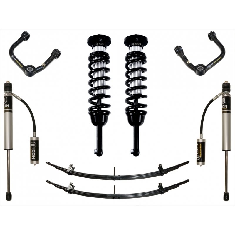

    When you say rebuild it what will they do exactly
    When they rebuild it after 30k miles

    These are straight from his website

    in a nutshell, replace the oil, seals, and refill nitrogen. basic shocks are non rebuild-able...but also cheaper.

    And how much usually would it cost to rebuild
    And who can do the rebuild?

    Are all lift kits need to be rebuild from time to time?
    This doesnt seem worth it all to me now if i keep spending n. Rebuilding

    No the OME and Bilsteins do not need rebuilding. It’s worth it if you value the ride and use them off road. If you’re just trying to fit 33” tires like I have said from the beginning OME set up or Bilsteins 5100. Keep it set at 2.5 so you don’t need to go aftermarket upper control arms.

    Stage 3 icon

    I was going to get Icon stage 3 maybe even 5 but after finding out that i will have to find a shop that will even try rebuilding them i decided to go with Bilstein
