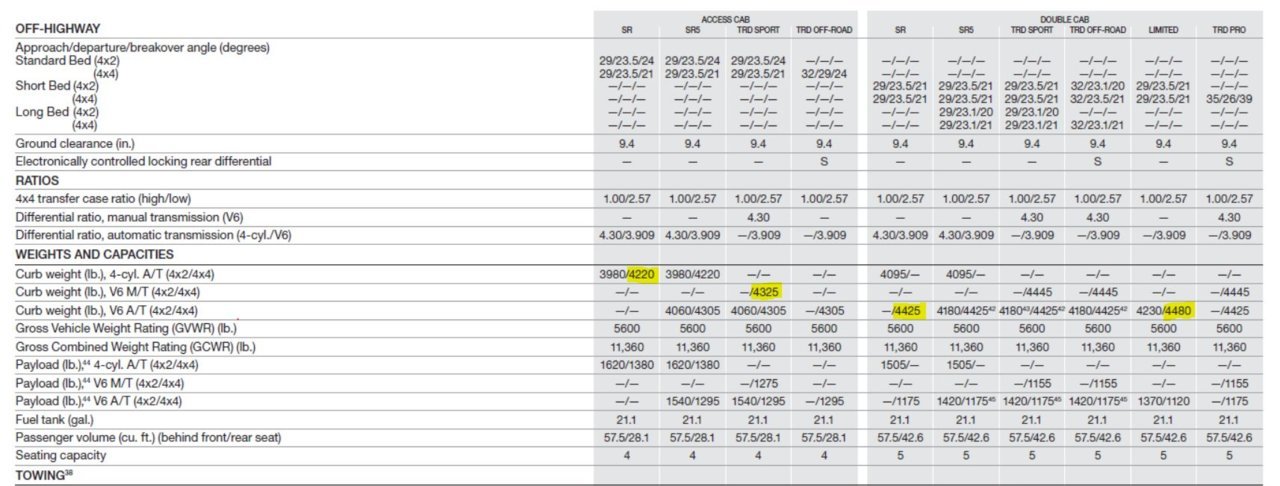

    Thread's a little old now but how were your results? The 3rd Gen DCSB weighs between 205 and 260 lbs more than an 3rd Gen AC. Per this spec sheet it looks like about 100 lbs of that is engine weight so I'd guess another 100 - 150 is in sheetmetal and accessories. 3rd Gen coils are 700 lb/in I think? Anyways I'd suspect you would not see more than 1/2" difference.

    I didn't take pre vs post measurement unfortunately (i forgot). Installing the coilovers in the front worked as expected and was pretty in-line with the spec sheet, it said i'd get around 2" and that's how they looked with minimal preload. I ended up pre-loading up to 2.5" or so. Maybe slightly more. The rear was a bit more striking. The medium duty Dakar leaf pack said to expect around 2" of lift in the rear, however it initially came out to closer to 3".
    When all is said and done and things settle a bit i'd imagine that i'll have gotten a hair more lift than a DCSB but it's not super material I don't believe.
