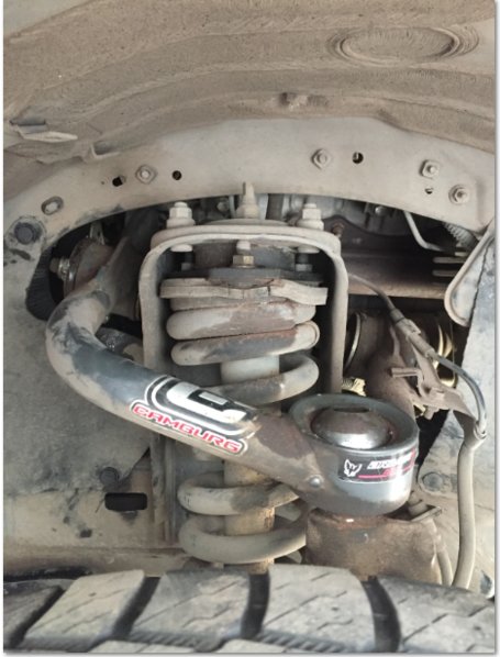

    Hey Guys,
    So I have an 05 TRD and need new shocks/struts. While I have to do that I decided I would go with the Bilstein 5100 set up and get a little lift out of it. So, I know that I will use my stock coils and go to the 4th setting for 2.5 inches in the front. But, my questions lie with the rear lift options. I am wanting to go with an AAL but the guy at Toytec told me that with the aal giving me 1.5-2 inches in the back, that the rear would still be higher than the front. I hate the factory rake and just want a lift + level appearance. Will the AAL really still make the rear higher than the front? I am just getting really confused with all of this and just want/need to get the right parts soon (can really feel the rear struts bouncing!) Also, with this set up, is a differential drop, axle shims and carrier bearing drop really necessary? Finally, attached is a picture of my coilover. Do I have a leveling spacer? I should know this but Im new to suspension components so I just want to make sure. My Front height (hub center to fender) is 22.5 and rear is 23.5

    Yes, you have a front spacer. With a spacer and your rear is still higher? You might have an aal, leaf pack, or block back there as well

    No spacer. 2.5 setting on 5100's are going to be stiff as fu**.

    I am also looking to take out the spacer and just run the 5100s w/o it. I dont want to preload the coils even more.

    Can you measure the front spacer? If its 1 1/4 or so its a 2 inch lift spacer. Knowing that will get us closer. If your rear is higher adding an aal will just make it worse.

    Its 1.25 ish inches (maybe a tiny bit less.) I have a bumper guard up front but it probably weighs 50 pounds or so in total.

    Okay thats a 2 inch level spacer then. See my post above on where 885s will get you.
    That 50lbs is probably causing at least a small amount of sag on stock springs. 5100 with 885 at 0 will more than likely solve your issue. If you end up with a rearward rake, do an aal.
