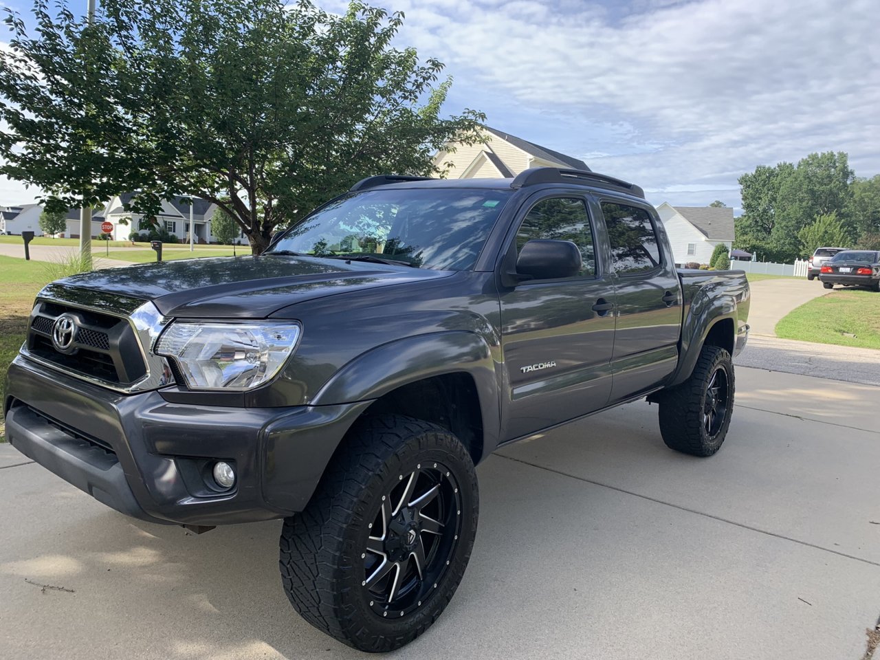

    Hey everybody, I have been working on my truck recently and need advice on how to lift the front of my truck. It is a 2012 PreRunner with a 3” body lift, the only problem for me is I want to raise the front about 3” since the wheel wells in the back are bigger than the front (Yes I already measured this and the front would only be about 1.5” higher than the front, so not squat). What would be the most logical way to approach this?

    3 inches is a lot. Almost looks level from pics
    And coil overs would be only option here I think

    I agree. Bilstein 5100’s would be an option.
    But I think you only get about 2.5-2.75” max.
    3” seems like a lot for the front?
