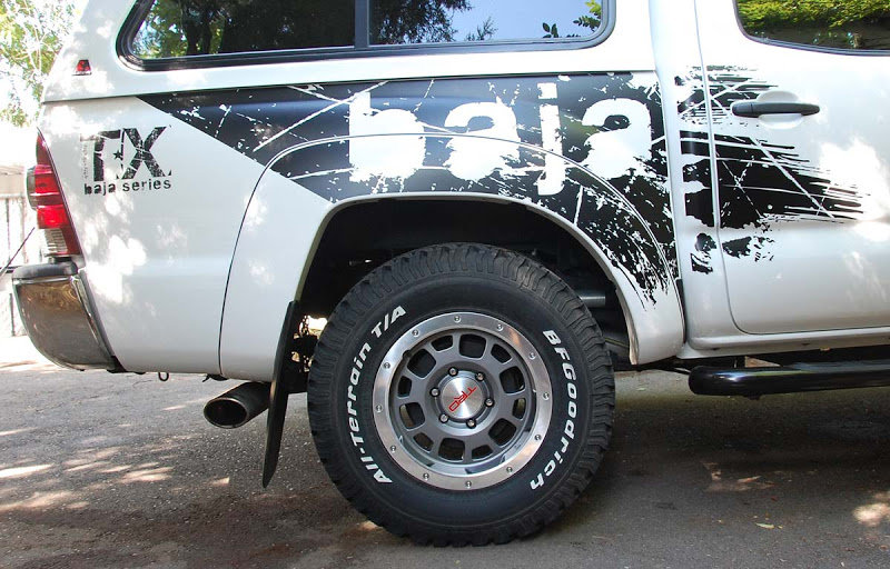

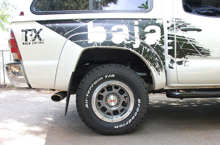

    You could go the $300 route like I did and throw on some Firestone Ride Rite airbags.
    Before:
    After:

    Agree... that's what I did after installing my Baja suspension. Sits perfect now.
