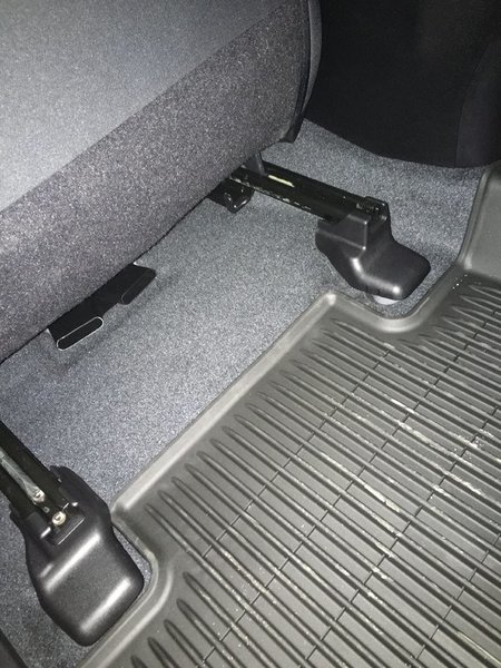

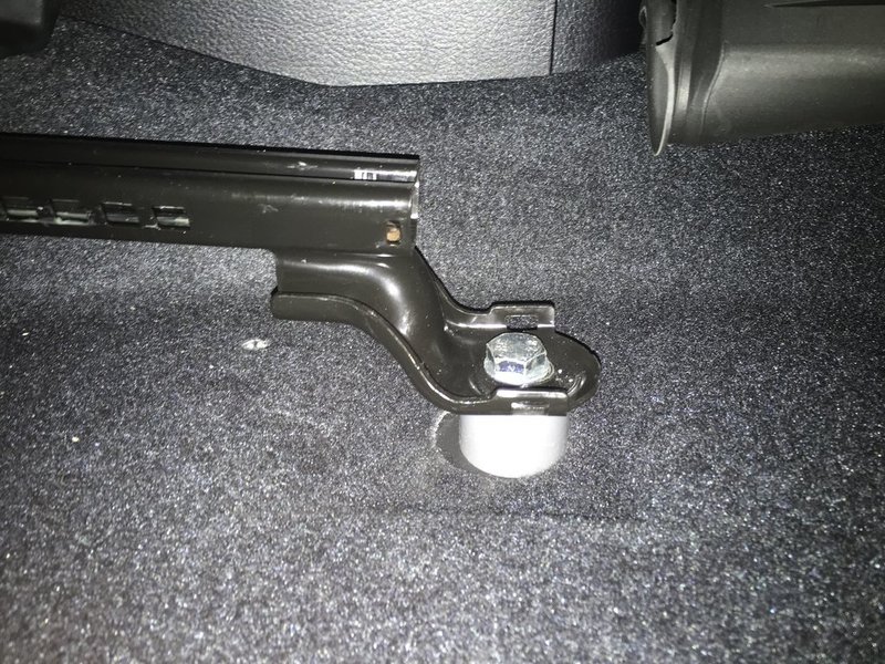

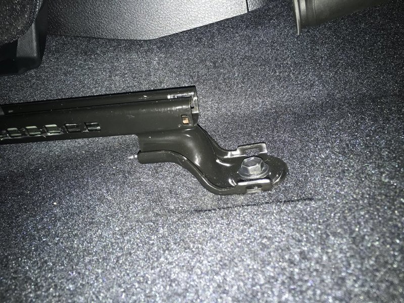

    Hey guys I just wanna let you all know that this kit works for the 2016. I picked mine up yesterday and switch over the seat raise kit. Worked great. Here's a couple pics.

    How does it feel? I just noticed the kit only raiser the back. Do you feel taller in the cab? Do you feel like your gonna slide off?

    Yes it just raises the back of the seat. The seat is already pitched up towards and even with the spacer, it still doesn't level out the seat.. It's still slightly pitched up, so you don't slide forward or anything. Because it's not lifting the whole seat, I feel like you don't gain the whole inch, but it is a noticeable height increase. I'm 5"7 and now like 2-3" from the cab ceiling. The visibility is better for someone my height, any taller will be cutting it close. Hope this helps!

    The longer bolts they give you with the kit are very solid. I cranked them down good. Not too sure exactly but if it's a bad enough accident where it would rip the bolts out of the floor, sounds like I'm pretty f#%ked anyway.
